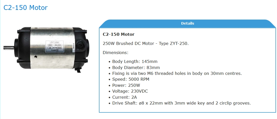

Can anyone tell me what the motor voltage is on my Axminster C2A mini lathe? I'm guessing it's a DC motor as it has speed control. Also the ampage or wattage would help too. Thanks.
If it's the same as the C2 lathe sold by arceurotrade.co.uk, the replacement motor is a 230V, 250W with a currect rating of 2A (I'm guessing it's not 1A due to the chopping action of the controller changing the input power factor).
