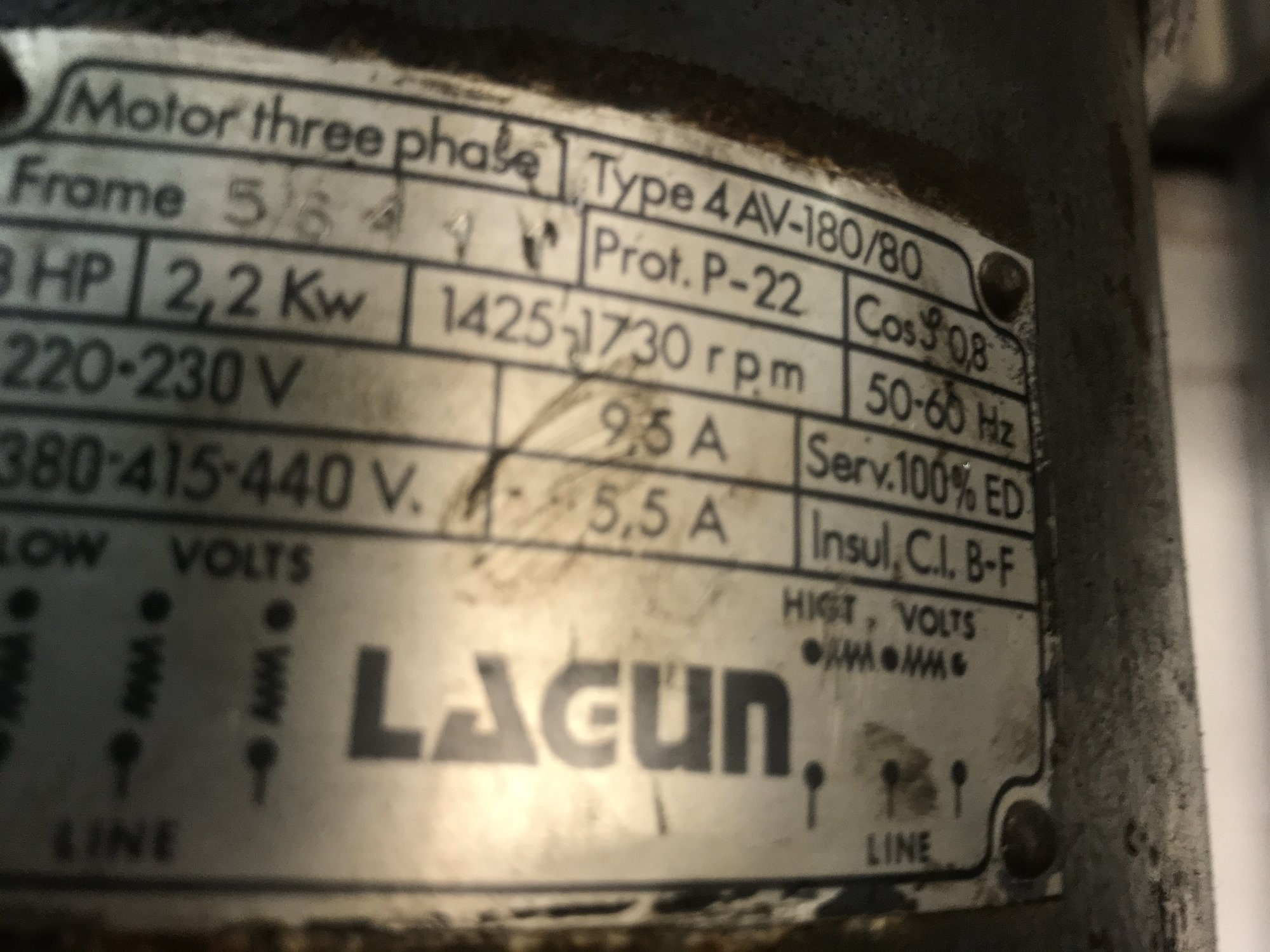

Yep, no problem - low volt connection bottom left of the label, 240 in and out VFD capable of 2.2kw (3HP) and 9.5 Amps as per the label (if going with a Chinese budget VFD get a bit higher rating).
You need to wire the VFD output direct to the motor, no switches etc in between, and do a simple bit of rewiring to make the machine's forward/reverse connect to the VFD's control inputs, possibly make up a control box for speed control BUT speed control is no substitute for the machine's own gearing / belt pulleys, a VFD gives progressively less power as you reduce speed, no point having it turn a spindle at 10 RPM when a gnat can stall it!

it can go into 3 phase or single
Good point about the low speed torque , also if there is a cooling fan in the motor running it at to low an rpm wont cool it enough , it's mostly ok for short periods but running it to slow all the time might cook the insulation (if I had to guess I would say half speed would be fine but check the motor case temperature when your running it.)
Most VFDs have relay outputs you can use, look in the Book of Destructions for "supervisory frequency" or similar as a setting, and how to set the relay to open above it (so the fan's powered below the configured frequency AND when the motor isn't running / VFD isn't powered - the fan switches through the normally-CLOSED contacts) - I set mine to 30Hz and use it to switch an external sock-blower OFF when it gets close to normal RPM and the motor's fan can take over. Having it run when the motor's stopped reminds me to switch off when I'm done, helps with senior moments

let me know if you need a 3hp 2.2 VFD mate as I've got one in my shed its the mini one if any good to you it's boxed with instructions but better off finding the correct perimeters out for your needsYep, no problem - low volt connection bottom left of the label, 240 in and out VFD capable of 2.2kw (3HP) and 9.5 Amps as per the label (if going with a Chinese budget VFD get a bit higher rating).
