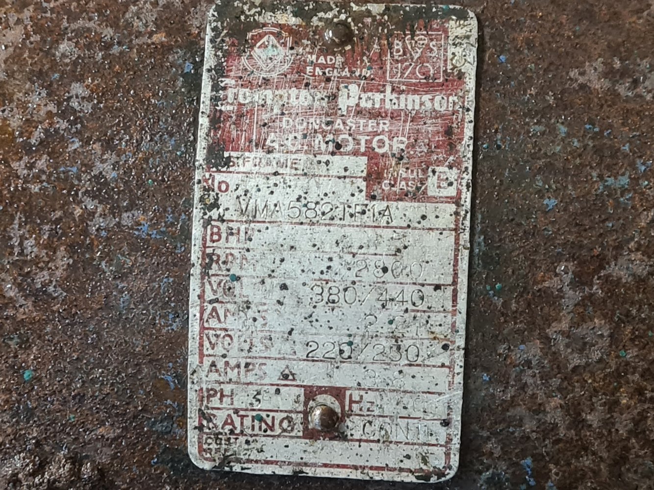

Oooh, can we have a thread diversion on power factorI'd have said around 1kW.
Thought it was polite…You need to ask?
2 HP... not possible.Dual voltage, two pole, about 2 hp.
Should be easy to run from a standard VFD.

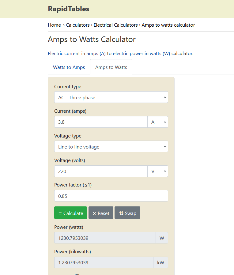

3.8A x 220V = 836W input power
