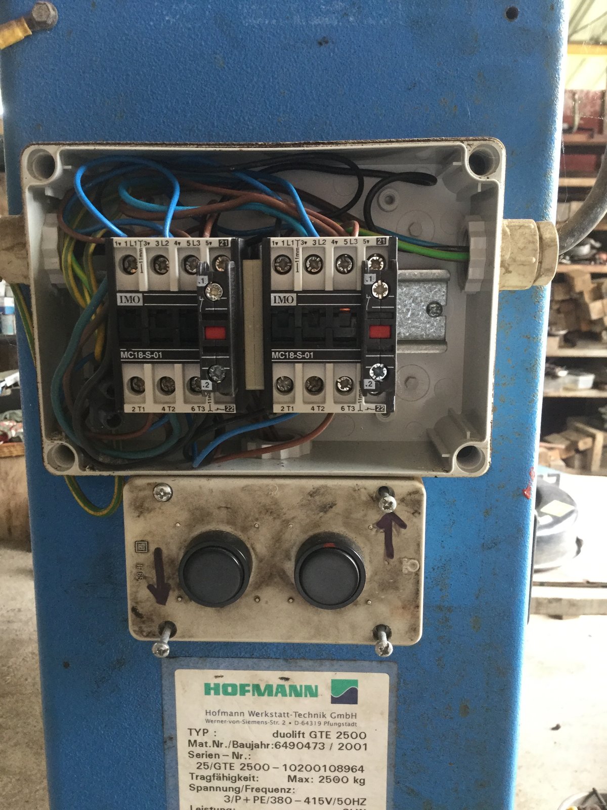

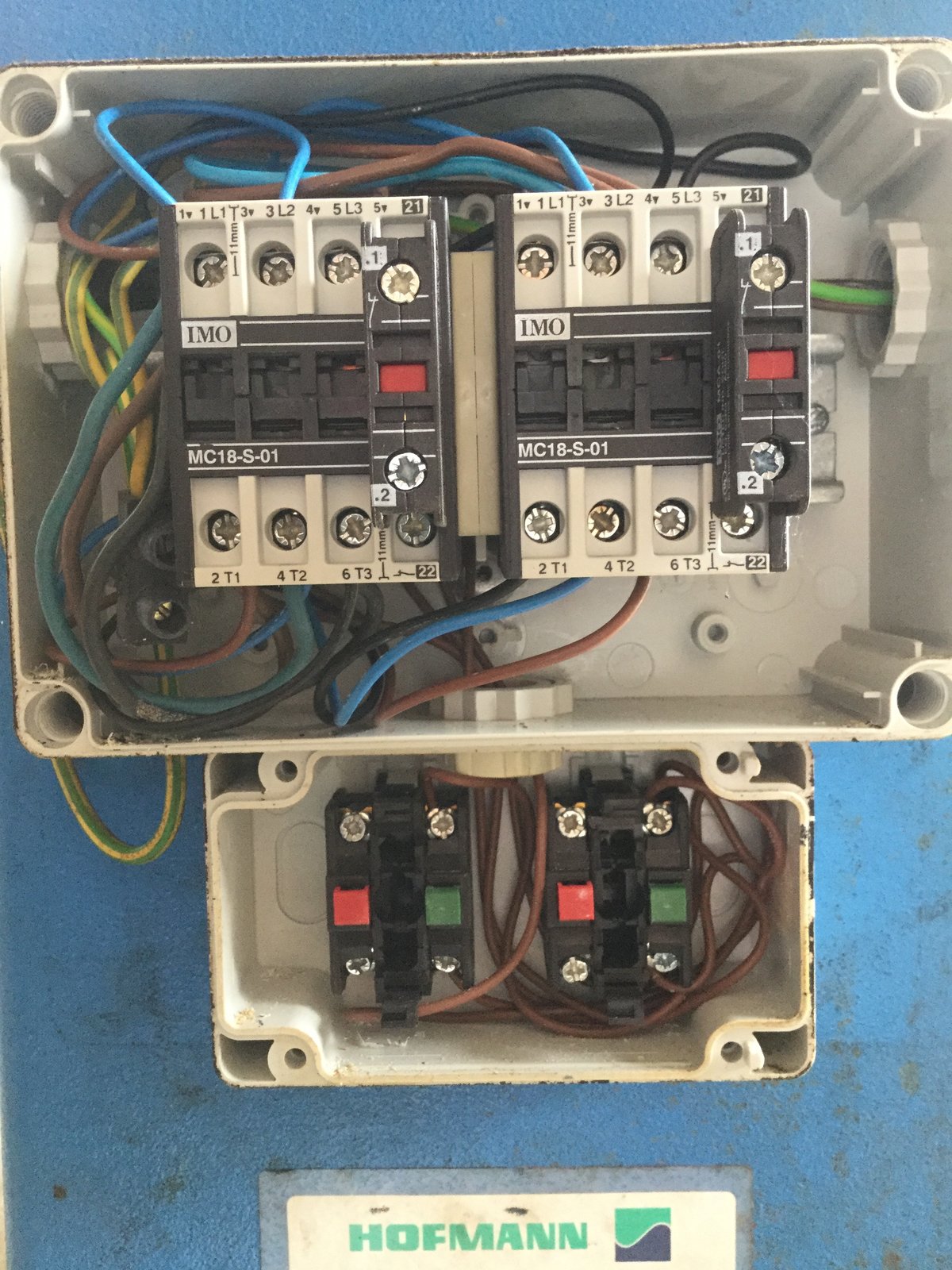

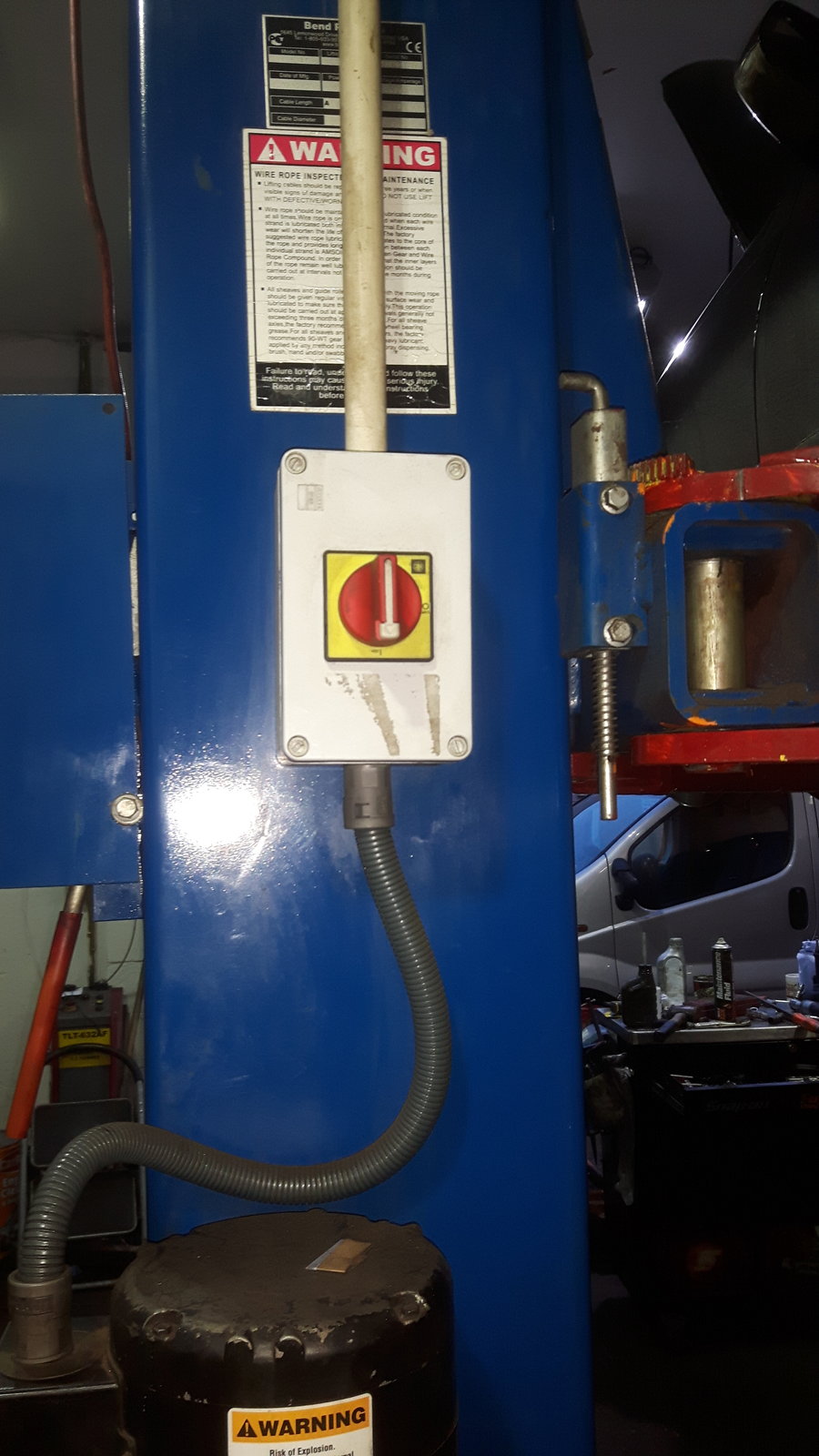

I have been asked to look at a couple of 2post lift that uses kraus Naimer rotory switches (that have burnt out on a few occasions) to control the 3ph motor but that is ALL they have, a 3ph rotary isolator on the incoming and a kraus naimer switch for the motor start, no motor protection at ALL !! the problem is a rotary switch will do it ( it has for 3 years or so) but IMO they are not totally accurate at the point they switch, as they work on plastic cams etc and that is not ideal for DOL motor starting and is that fact that is burning them out, they also are VERY expensive at £70 +

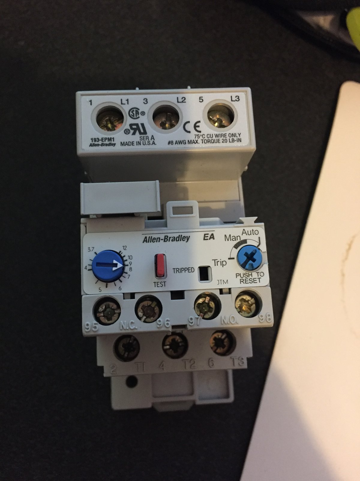

My idea is too use a 415 coil contactor and momentary switch to switch the motor in with an overload at the bottom (obviously set to the motor current), I would use some protection for the 415v coil and switch wiring but would it be better to use double pole protection ? because if one side trips the other is still live, through the coil, or use a small 415v isolation tranny and use single ph 230 protection or even go to 24 v?
the way it has been designed leaves a lot to be desired IMO as having no motor protection seems crazy with a 4/6amp ish motor dol on a 32a C MCB.
does make you think about designers and installers etc allowing such to be used each having 32A c mcb's !! the switch is 20 amp ish and the motor wiring looks to be 1.5mm
