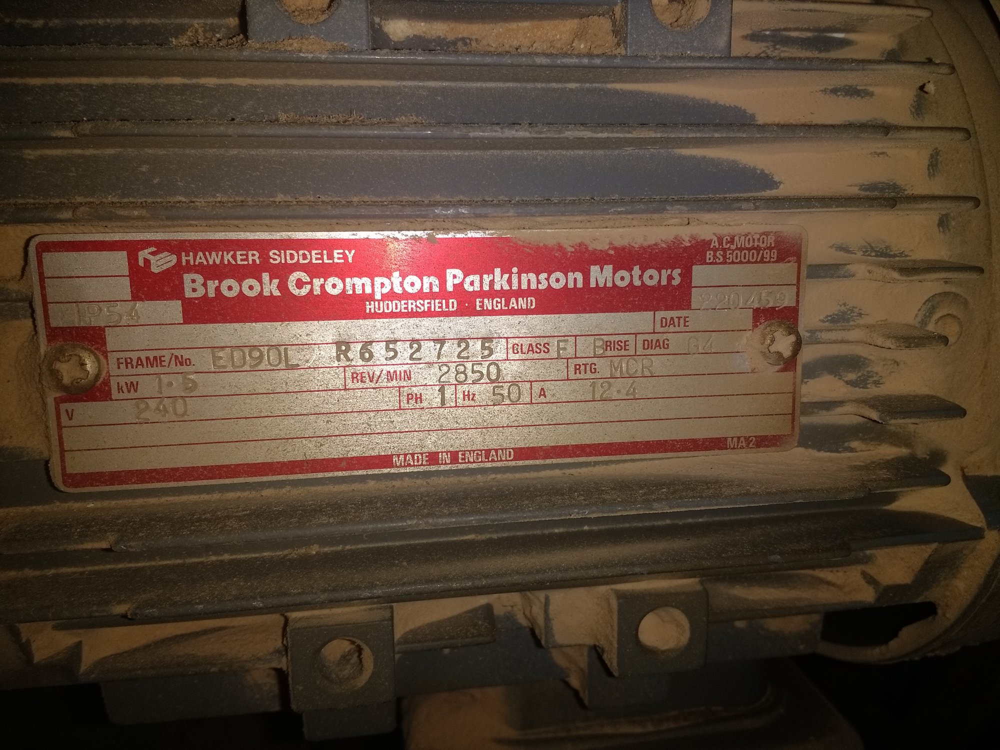

Here's the photo -
So, 12.4 amps @ 240v = 2976 watts
So, why does the plate say 1.5kw?
The motor won't spin up on a 13amp fuse with any resistance. I've not tried a nail yet... : )
I'm guessing the quoted 12.4 amps is running, rather than startup, when it's probably pulling more. But, again, none of that adds up to 1.5kw?
