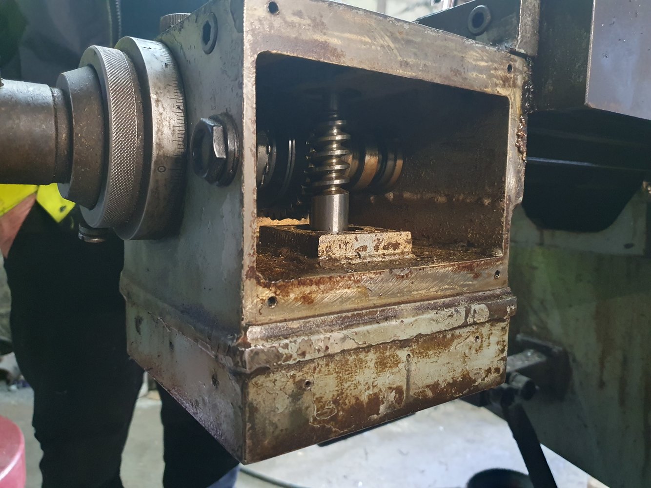

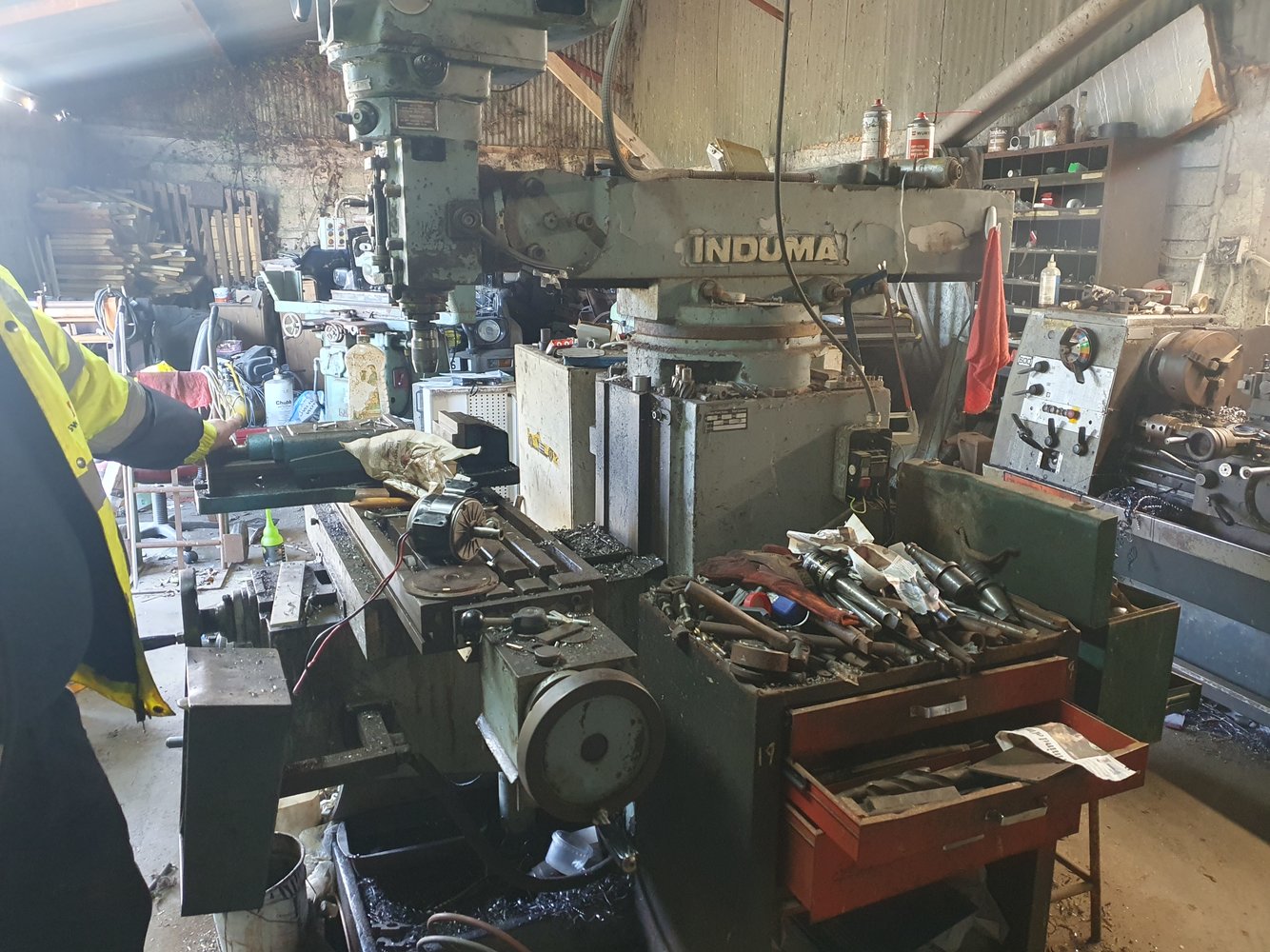

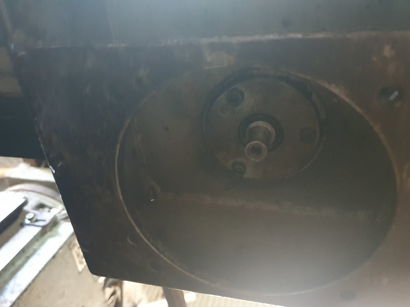

A friend of mine is a machinist and does various jobs for people. One such job on the mill was cutting keyways into shafts, and he had a few to do. With his machines being manual, he was caught up winding his bed over and back quite a number of times.. I gather it was a major PITA!
So.. he has asked me (very novice) to help him setup a motor he acquired a while back to motorise the bed.
Unfortunately I don't have any pictures of the machine in question but I will get some the next day I am out.

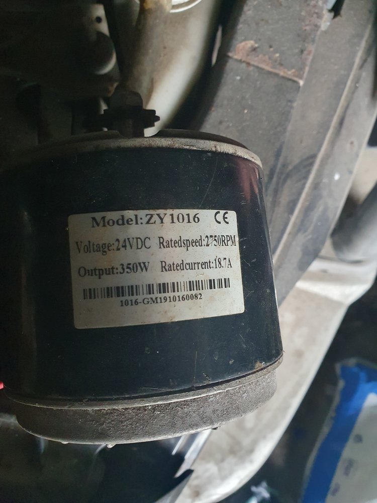

The motor is as follows:
24VDC Brushed, 350W, 18.7A, 2750RPM
