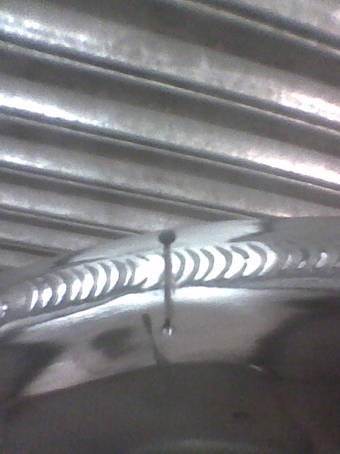

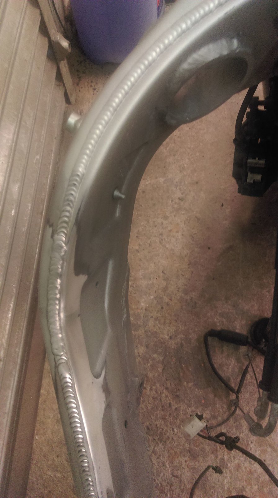

Yes it is.Is cracking in that location common to that model of bike?
I don't fully agree, they seem to do quite a few years before they crack and this repair has only lasted 12 months.Well its logical it would crack again in the same location as you havent removed the cause for the initial crack. Be it stress, vibration or what ever!
There's at least a couple of different alloys in use. 7020 (probably T4 but that's a guess) is used by a lot of the aftermarket frame/swingarm builders as well as some OE. A 6xxx series would be the other choice, most probably 6061-T6
All aluminium alloys are softened (weakened) by welding. 7020 (or 7005 depending where you live) is 'damaged' less than the 6xxx series; it takes more time at elevated temps to anneal and naturally 'age hardens' quickly although artificial aging (lowish temp bake) yields better results. Not particularly formable, don't think it lends itself to the complex extrusions used in frames but it is used a lot for subframes and parts with simpler sections/shape
6061-T6 is weakened significantly in the heat effected zone by welding, depends who you speak to (and how good the welder is) but you're looking in the region of 50% in the HAZ. It'll recover a little from that over a few days/weeks but really needs both a solution heat treatment and artificial aging if it was designed to be used in the T6 condition. It's a VERY common alloy with good 'all round' properties so a lot of stuff gets made out of it
Be careful about 'just plating up' an alu bike frame, the harder alloys that are used for frames are pretty sensitive to stress risers- aluminium has no endurance (fatigue) limit, any stress risers WILL accelerate
Kawasaki zx9r, This model is known for cracking but like I said , I'd have hoped my repair would have done a bit longer.What frame is that Woody?
I’ve repaired a lot of Honda and Yamaha bits. The filler metal in the constructors manual is always 5356 for frames
