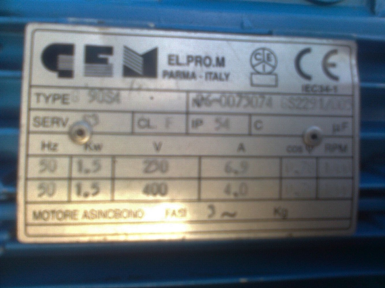

Next q? Would an end flange mounted motor be ok with a pulley on it
Cheers @AgroshieldYes. Same bearings. If the customer wants flange mount, they bolt a bit on the end of the body. If the customer wants foot mount, they bolt a bit on underneath it.
You have the motor?
No, don't have the motor yet, hope to pick it up this week. I understand what you say, if it arrived to someone wired delta and they wanted it to run on 415v.
Ok thanks Dave.Probably has six terminals in the connection box, star will have three on one side linked, phases down the other side: to swap to delta (for 240v) move the links to strap across the terminals like an E (but without the upright), leave phases where they are (if it runs backwards, swap two phases). Easy peasy.
