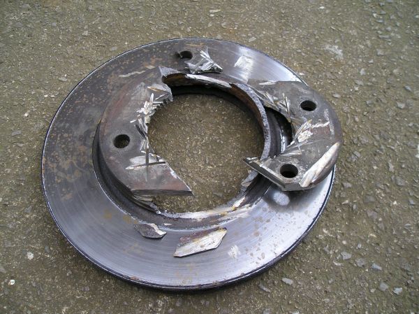

First problem, can't get the disc off the driver side, rusted up solid. Drilled some holes in it and squirted WD40 in, no go. Cut some groves with an angle grinder, no go.
Started cutting on the outer part of the disc to get to the hub, chiselled a bit more disc out of the way, did the same at approximately 180 degrees...
sharpened my chisel and finally got a bit of movement...
then the disk disintegrated!
