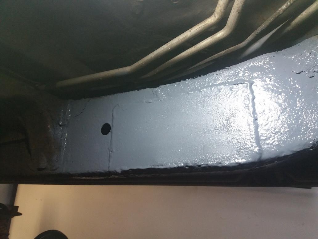

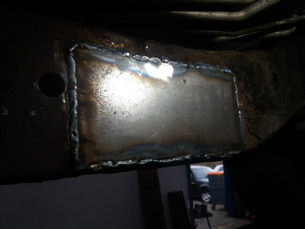

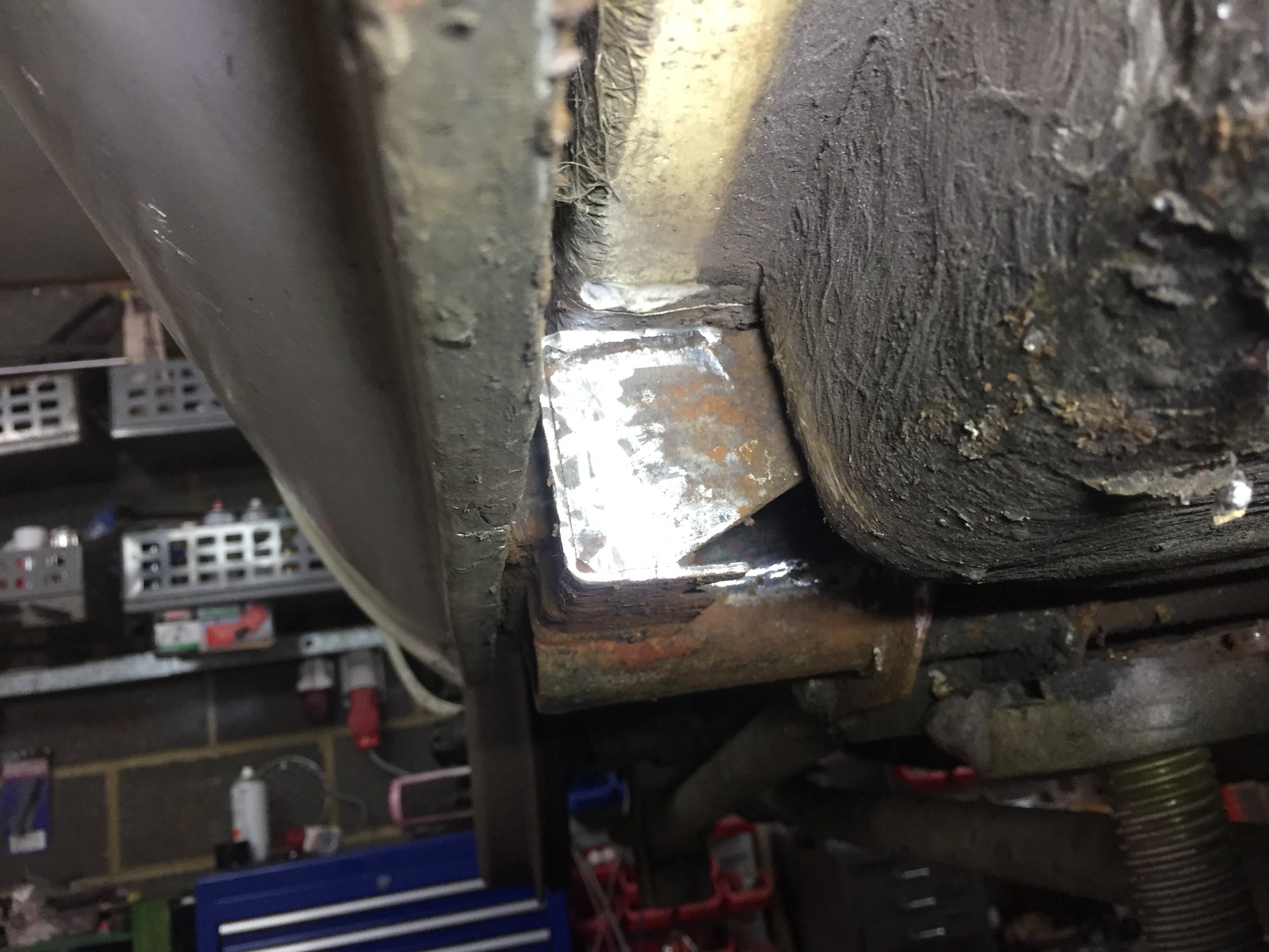

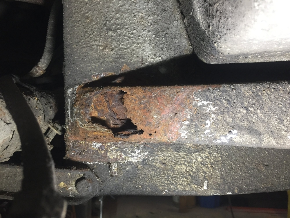

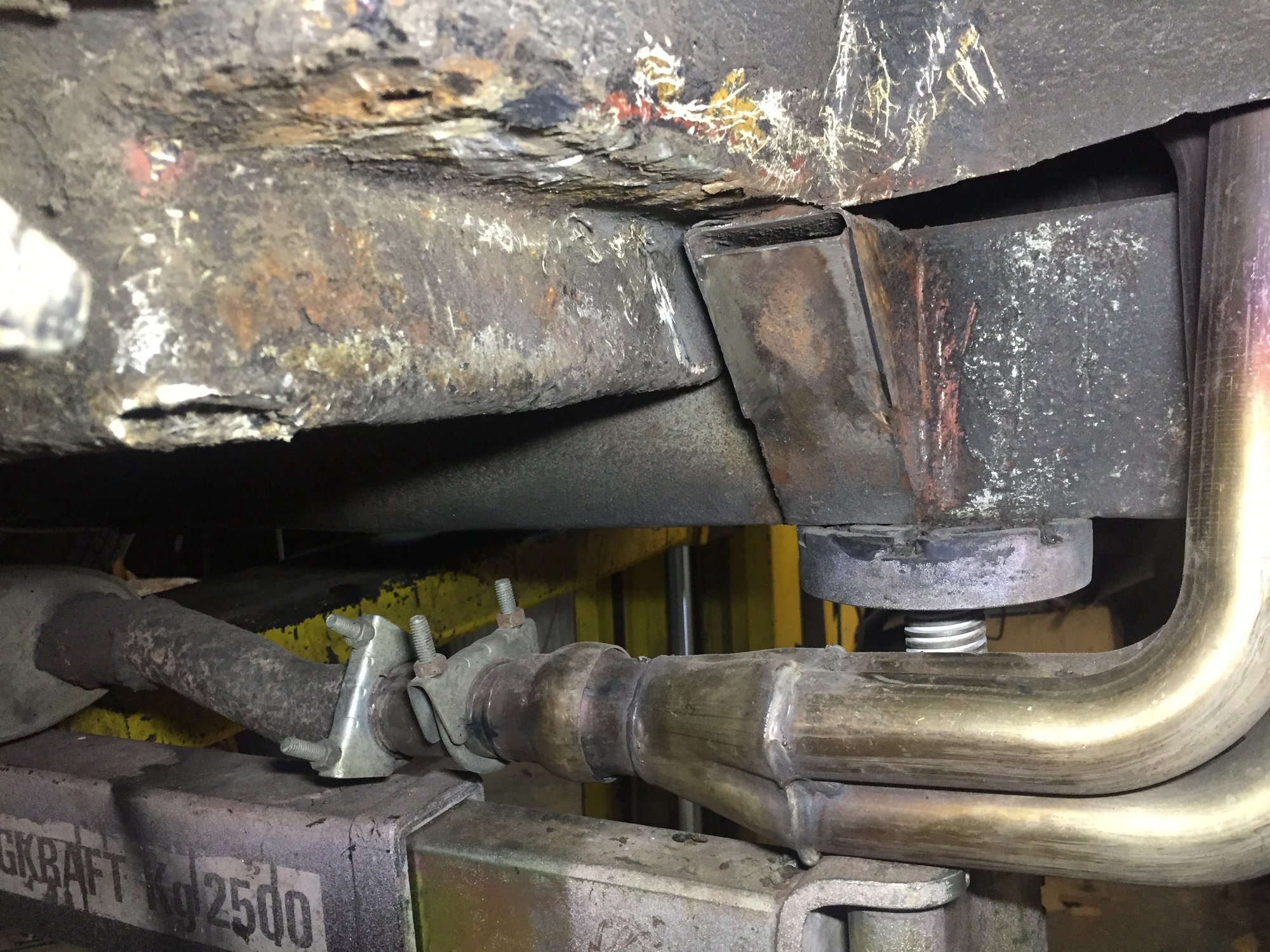

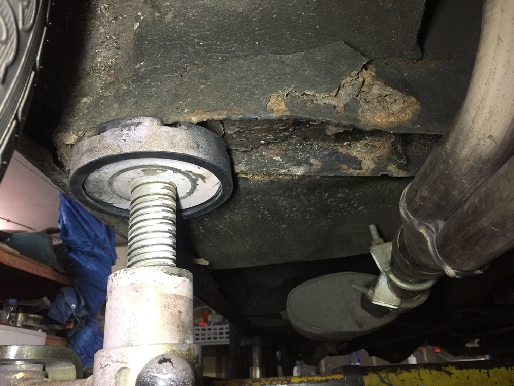

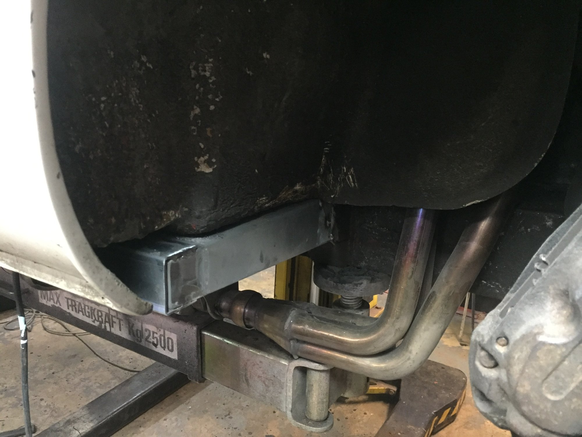

I repaired this today not the sort of work i like to do

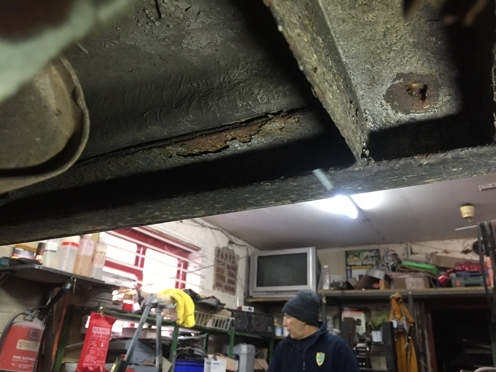

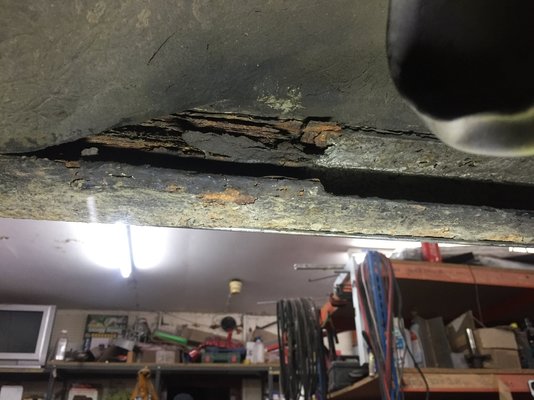

It failed a test at another garage
The picture was for there benefit before i under sealed it
Patch was 4 mm plate fully seam welded
