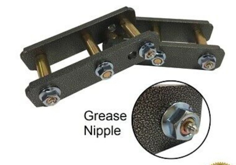

Most of the adverts for them just state "steel" so they are probably something like EN3 mild steel , you could use EN8 carbon steel for extra strength, I guess it depends how big your truck is.

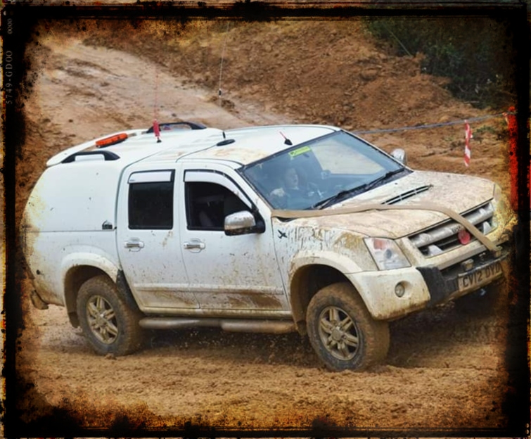

Standard isuzu currently but do a mixture of off roading and towing so need them on the strong side.
I was thinking about this and its very difficult to suggest anything without some knowledge of the forces etc involved
I did wonder what bolts were used or what was available. Does it make sense that the hanger should have a strength at least equivalent to the bolt. You can find out what that is
