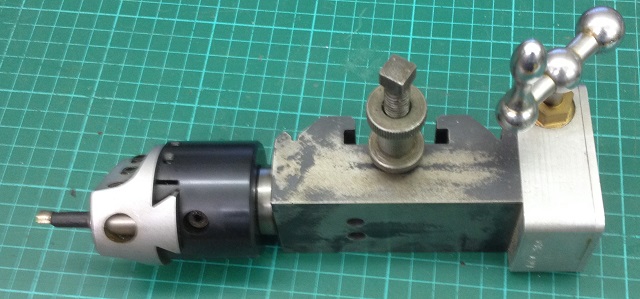

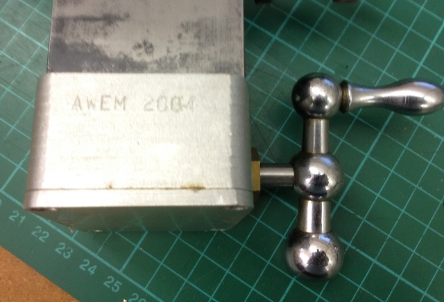

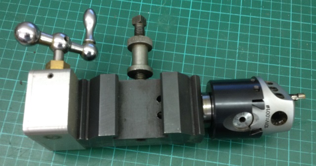

Don't suppose you have any build pics etc. I can't quite see how it works..I have several of the morse taper socket T2 sized Dickson holders I've acquired over the years, and I have to say they're not the most useful holder in the set ! Being T2 the socket is No 2 Morse so presumably yours are T3 or smaller?
The most useful thing I did with one of them was to bore it out and make a Ball Turner based on it . Looking at the pictures it seems that was in 2004!
View attachment 77540 View attachment 77541 View attachment 77542 View attachment 77543 View attachment 77540 View attachment 77541 View attachment 77542
Youre not thinking it through, you have all the adjustment required to centre the tooling relative to the chuck. As I said a coaxial indicator is fast way of dialing it in.
the tailstock on a lot of machines can be easilly off centre too
you would have to set the tailstock up every time you moved it...if you were cutting long tapers etc then it would need setting up afterwards...i have known a tailstock to move after being knocked on a hardinge lathe i used to work on.
using a toolpost holder could be better than using the tailstock espceially on smaller lathes that arent as sturdy...my chester had a fairly sturdy tool post but the tail stock was a bit iffy...didnt know at that point that you could get these holders though
And if my aunt had balls, she'd be my uncle. Yes you would have to set up the tailstock every time IF you were cutting a taper. If not, you can generally rely on it not to drift. My Colchester Student would survive a small thermonuclear blast so I wouldn't expect it to drift that far out of dead centre with anything less.
Having said that, using a live centre in the toolpost holder to cut tapers might just be the most useful purpose for having one. Then you wouldn't have to fiddle with your tailstock every time a Nuke goes off...
