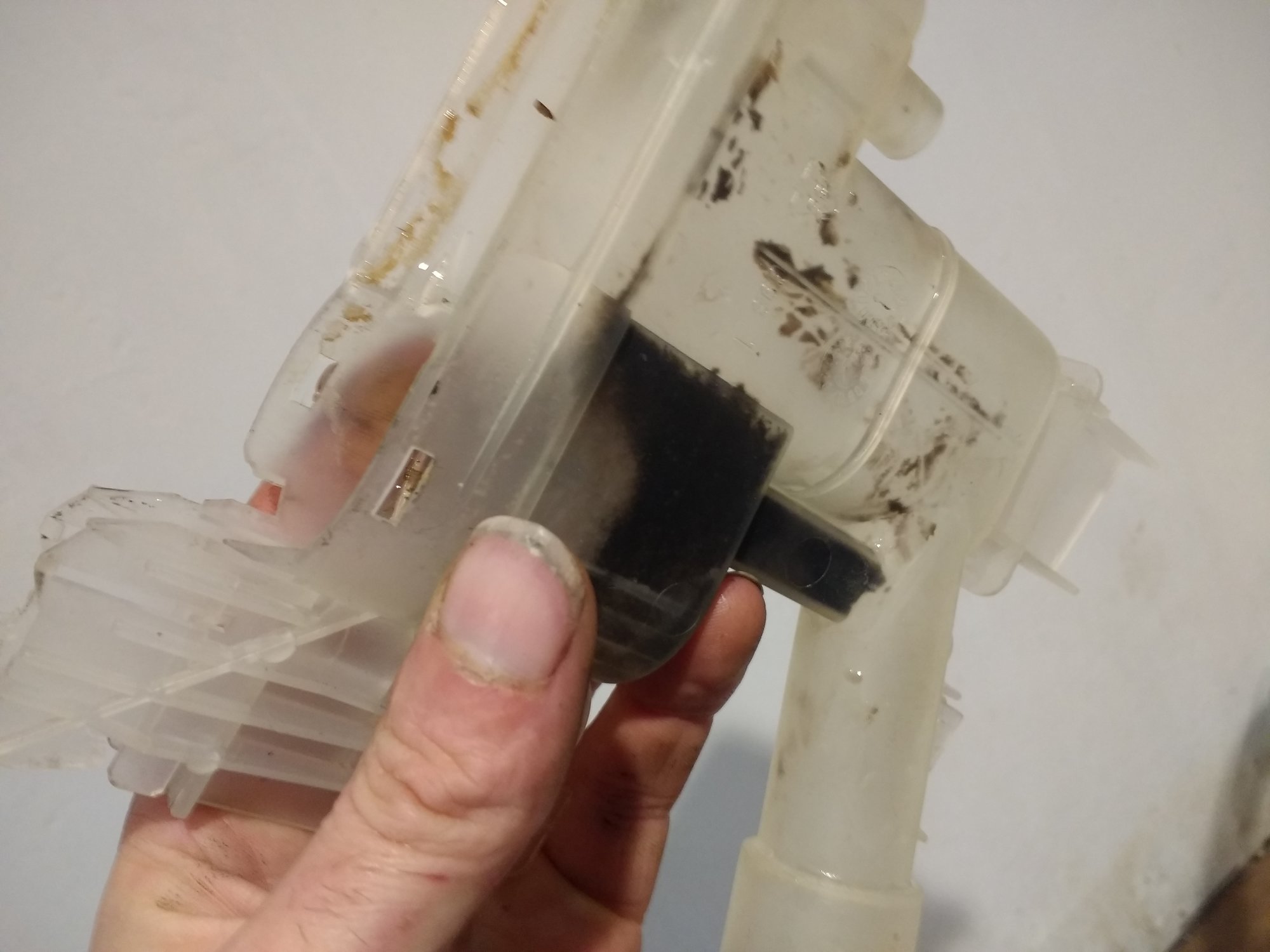

So, just recently, with the forum help, I've managed to avoid buying a new tumble dryer (stuck relays) and fixed my compressor (various faults) and now the dish washer has died!
It's an old Bosch one. It must have a PCB somwhere but I also wouldn't be surprised if it was just relays.
Here's a photo of it, it's a really basic one -
The issue is that it's not filling with enough water, so the pump has nothing to pump really.
It seems to fill with a bit, as the feed pipe "jerks" as the solenoid shuts off, but not enough.
I can tell this by setting the sprinkler arm to a known position, and, when I reopen the door, whilst it's dripping, it will be in the same position, and I can't hear it spinning from outside.
If I manually Chuck some water inside, it's all back to whooshing about again.
Until it tries to drain and refill for the next part of the cycle.
We have had the unit for years, and I replaced the solenoid about 6 months ago, as the old one was not shutting off perfectly, so would dribble over time, causing leakage.
I mention this as the solenoid is then quite new, but has been working fine for about half a year, maybe longer.
My question at this stage is how these machines know when to stop filling?
I'm assuming they're not just timed, and they have a sensor?
I guess what I don't get is that the external feed pipe shudders as the solenoid closes, so there is some flow, but obviously just not enough (for whatever reason) is getting into the machine.
I need to work out why.
Thank you once again!
