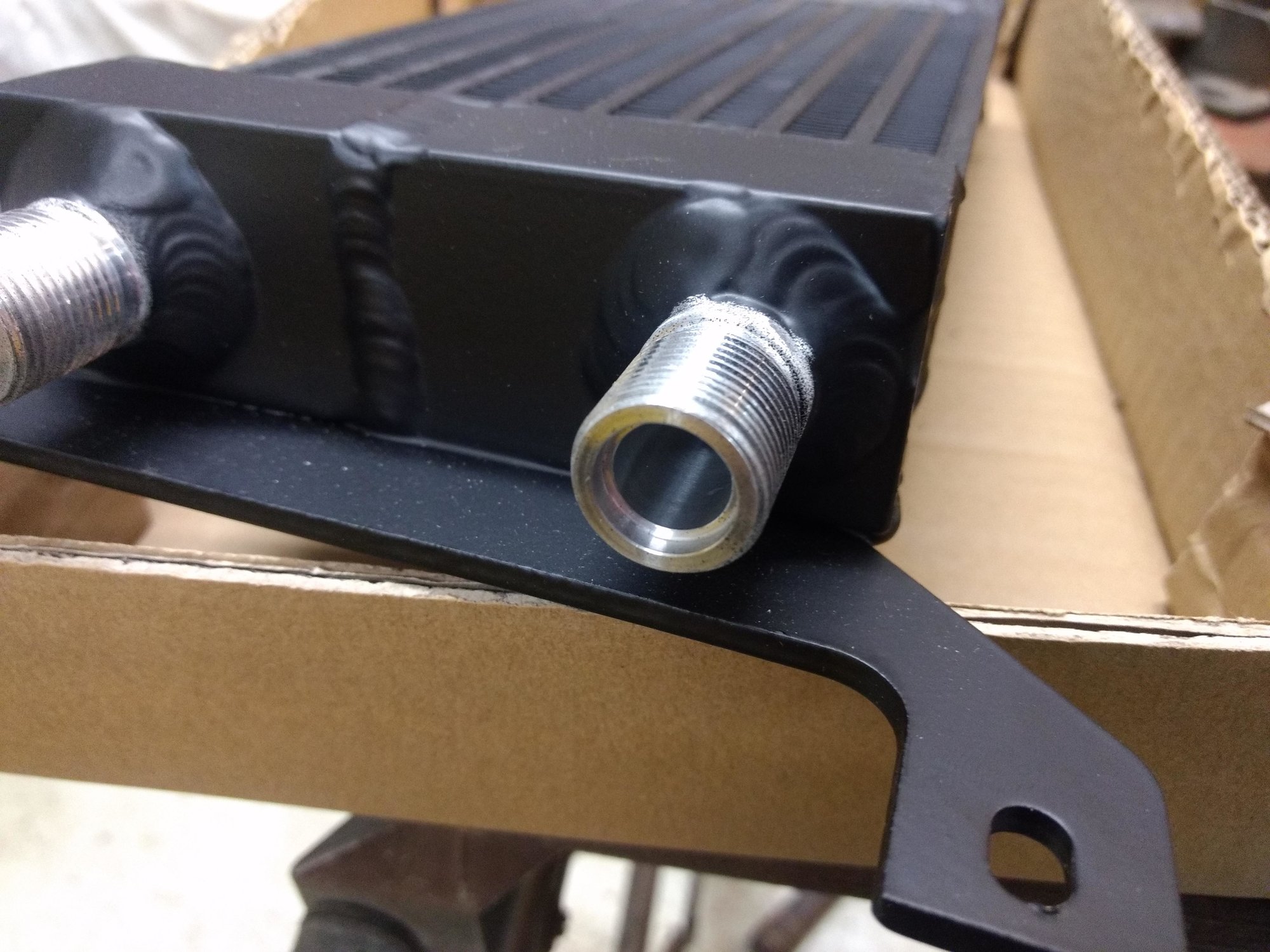

I measure it at 16 tpi and a diameter of .775 inch (19.7mm) which is quite close to 3/4 UNF but the diameter for that should be 0.75 inch (as the name implies)
the unit is a land rover oil cooler but standard pipes are not an option as it will be used for something else
From the ledge I am assuming it will be an o ring type
