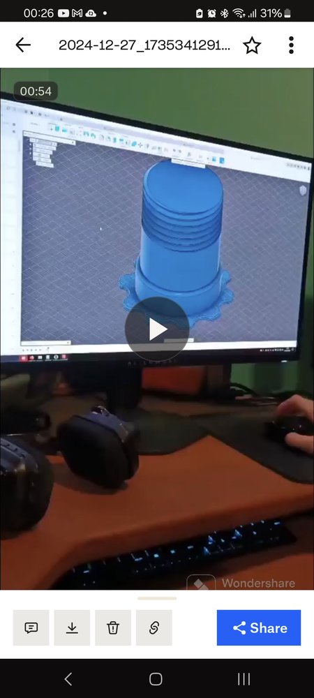

well I have spent 2 days cutting an object. but when I combine it says multiple objects.
Dropbox
www.dropbox.com
any suggestions other than giving up 3D printing.![]()
