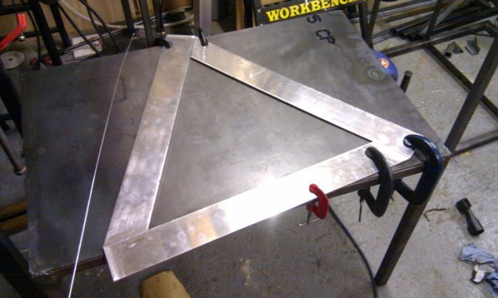

Halfway through a project to make what is, in effect, a bigger version of an axle stand. It's for my father in law - he's got a dinghy and where they're kept (on grass) people like to tilt the front of their boats up to avoid some of the weed growth.

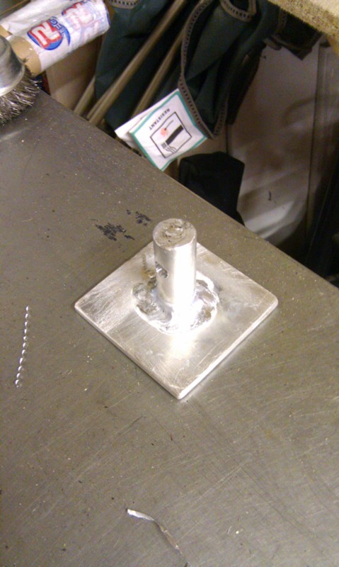

It's 5mm ally plate, and it's the first bit of useful aluminium welding I've done (I did some practice runs and made some vice guards before).
I'm using a 160A AC welder, which is way underpowered for 5mm, but it'll still put a useful join down. The top piece is a piece of 20mm dia solid rod. Not the prettiest but I'm pleased with how it's secured on, and is a continuous beed.

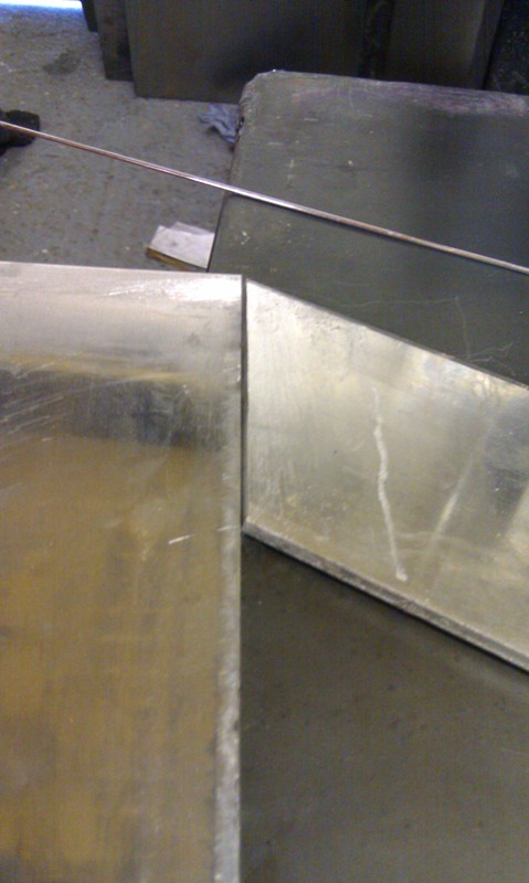

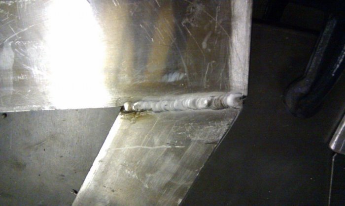

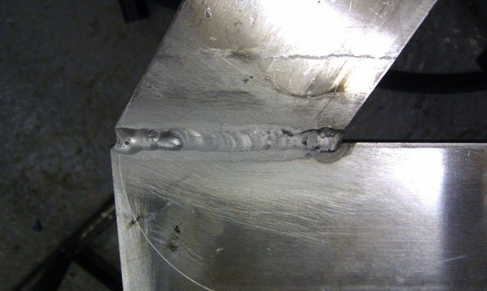

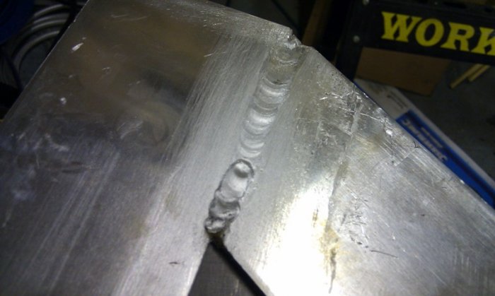

The butt welds for the base triangular frame I did a top pass, with a very slight vee - put in using the jigsaw canted over. I then went along the bottom of each butt as well. On one I had interesting, and instant, cracking right down the middle of the weld fillet, from the end where I finished welding to. Interestingly, remelting it again made the crack instantly reappear, I filed it out in the end to get rid of it and then it was fine.
I've been using the jigsaw with a metal blade to do most of the cutting, it's done a really good job, and noticeably better when I apply oil (from an old trigger oil can, in fact I just use clean motor oil).
Any comments, and explanation of what happened on the cracking would be gratefully received! I think perhaps I should have put more of a vee in and left a gap too to weld into.
Welding current was mainly 120A, but I was on the pedal so varied it accordingly.
Sorry - last question - the start of each weld was iffy (I was on it for quite a while to get a bead to form) and also how do you finish off a butt without getting the edge to burn back?
