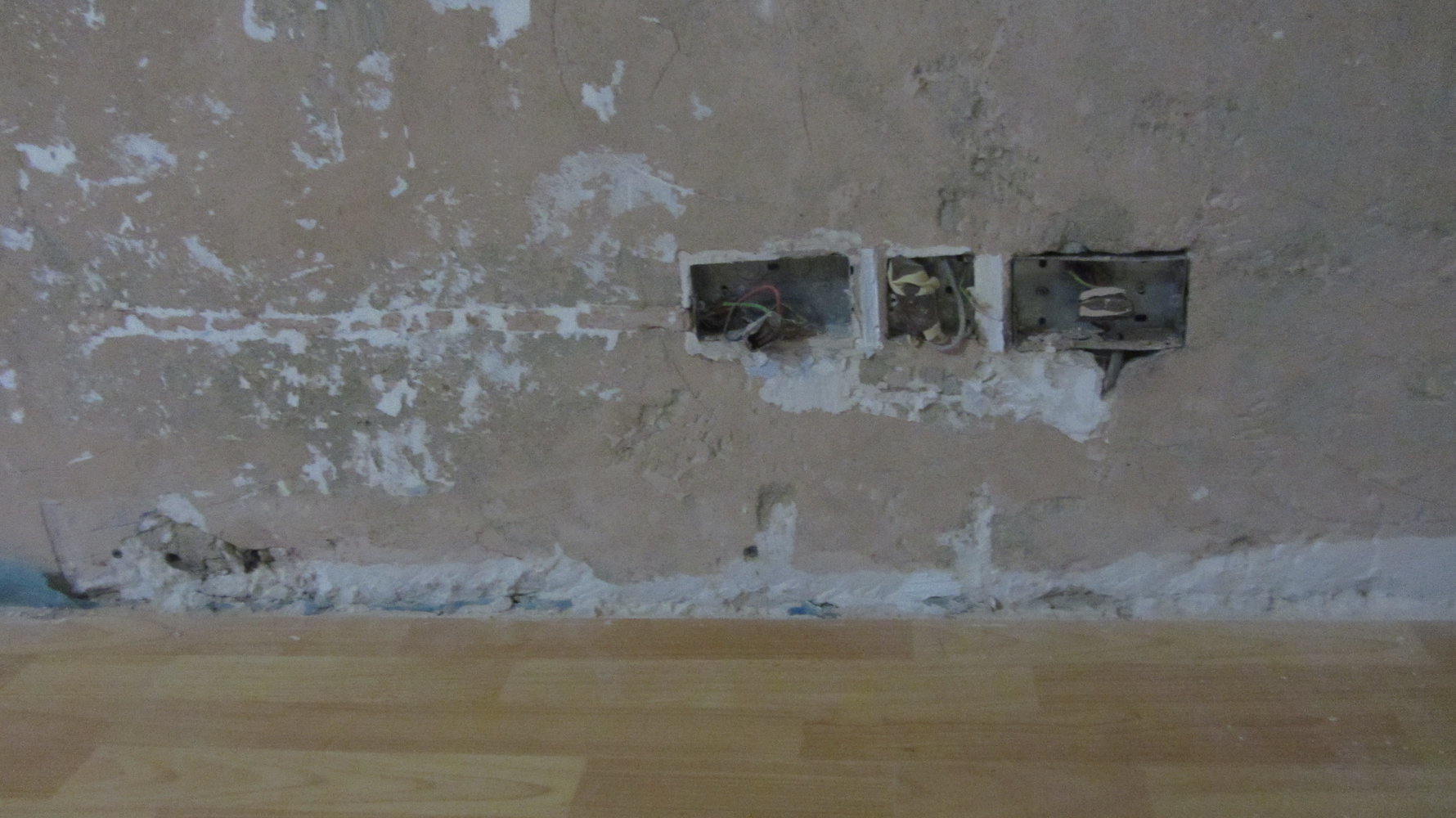

This was what greeted me after cleaned the plaster off the wall.
There are 2 nasties here.
1. wiring from right socket to (ring final) to the left socket. A wardrobe had been installed in the corner and covered the right socket, so they put in the left one.
2. See if you can spot it, bloody dangerous in my opinion.
For 1. I plan to remove the ethernet box chase out the wall and run a cable in 20mm steel conduit between the 2 sockets and then refit the ethernet socket - not ideal but safer than now.
