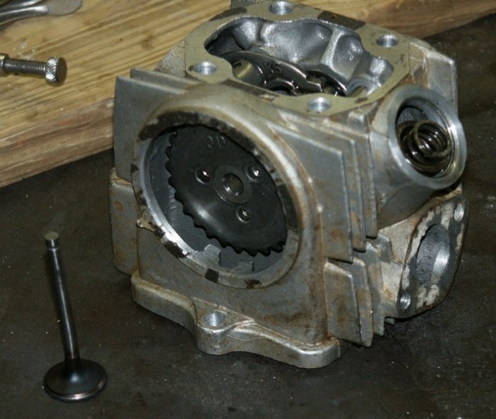

A neighbor brought a small 4-wheeler over for me to look at ("Get MacGyver to fix it.")
It is a SUNL 90CC. Never heard of them, but are real cheap.
Figured it just needed battery and the carb cleaned. The carb was filled with green goo. Cleaned it out but all I could manage to do was have it backfire.
Turning by hand, I could hear the carb sucking/blowing as the crank rotated in any position. Figured it needed valve adjustment. The valve clearance still measured close.
On further inspection I found this:
No, that is not barrel distortion from the camera. The valve is bent. Odd is it sat 1/8" open and the clearance was still right on the camshaft. There was no "eyebrows" on the piston either.
So, the valve must have stretched as it bent. Must have bee a real soft spot in the metal.
Was about to tell neighbor it was trash, but decided to check on parts. An entire head with valves, cam, gear, springs, gaskets, covers, everything is $70 shipped. I can't even get a head gasket for one of my bikes for that price.
Dropped the new head in along with a new alternator stator. Looks like someone connected the batt backwards and fried the coils. That was $27; jeez. A stator for my GPz is something like $250.
Runs fine with new head but needs some more carb cleaning a sit does not idle well.
Even with slave labor, I can't see how they can make it so cheap even buying through a US dealer that has to mark them up.
