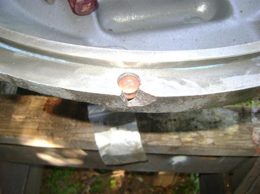

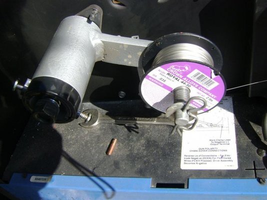

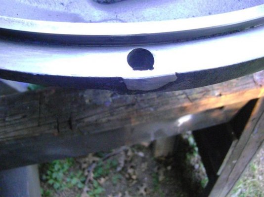

I have been welding cast with my mig for the last few months and love it for some jobs like this one. Its a bellhousing that had 2 holes chunked out. I put some copper slugs into the holes gave it some preheat and welded some vertical stringers filling the area nicely. A little grinding and its done. I did this with crown alloys cast iron mig wire and argon gas...Bob
