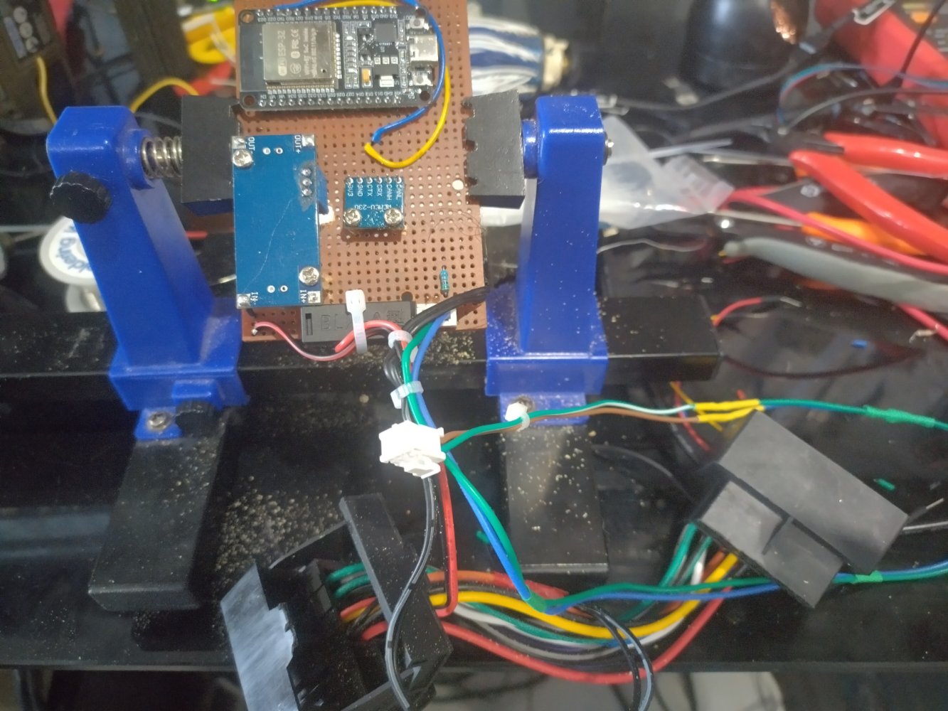

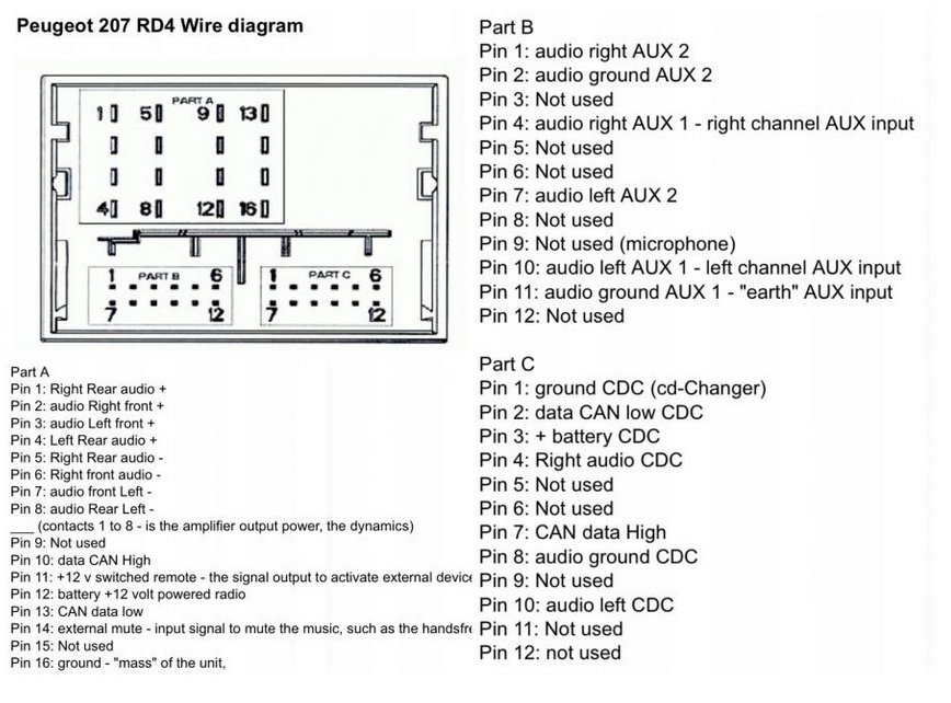

First there's signals in the quadlock connector we can tap into for this in part A of the connector to the audio head unit. +12v and gnd for power, and CANH and CANL on pins 10 and 13.

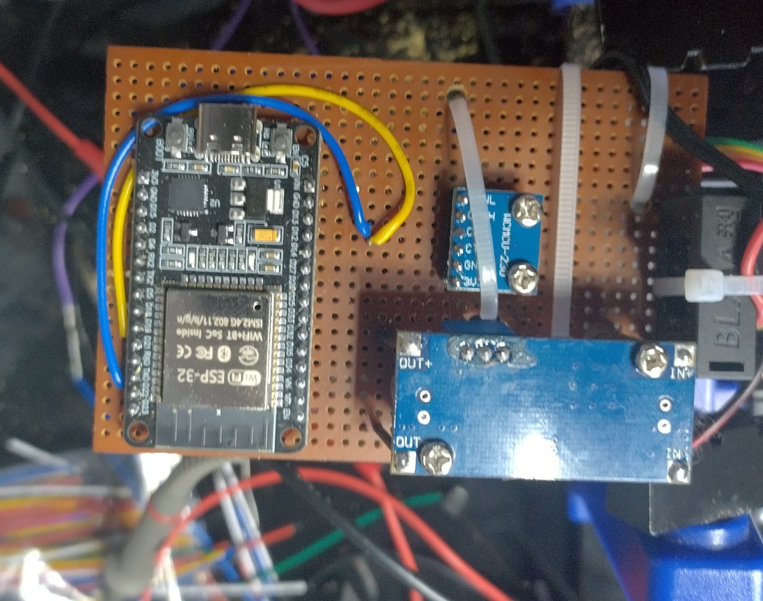

I made a layout on vero/proto board to hold a buck-boost converter module to convert the 12v of the vehicle to 5v, a Esp32 dev board, SN65HVD230 canbus board designed with interfacing small microcontrollers like ESP32 and arduino to CAN buses in mind and a fuseholder. I will make a nice pcb in KICAD and 3d print a case for it and choose a smaller buckboost module when its all working and tested (probably, maybe, the best intentions and all that...)
I also added lead tails to the canbus connections on the pcb so I could plug in my oscilloscope and logic analyser to get more insight. Logic Analyser sounds fancy and expensive, but its a 11e Saleae clone off ali express that I use under linux with Sigrok + Pulseview.
The ultimate aim is to leave the ESP32 board in the car, and have it communicate the stalk data up to the headunit via a serial interface the chinese android boxes have, in a format the headunit speaks properly.
It doesnt even have to be the same car since we can remap it to whatever ID we feel like on the fly, just has to be a supported one in the head unit.
Behold the device named "GiraffeBasedViolence" for some obscure reason probably involving hardly any sleep and fatigue, before it was swaddled with kapton tape to stop shorts in the dash cavity.

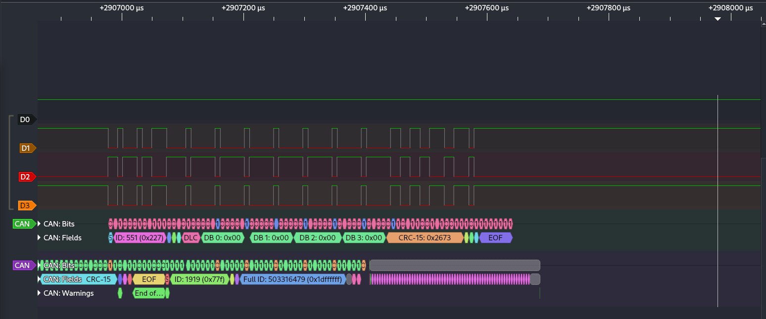

Using this and the saleae, after a hiccup caused by the CAN board having its own termination resistor was resolved bydesoldering and putting the unneeded extra terminating resistor in the bin once i found it, I was able to get CAN frames out the car itself.
Pulse view is linux open source software, and great for this kind of thing. The CANL & CANH pins of the can interface board are on channels d2/d3. So I added a can Decoder to these to see traffic after setting parameters around bitrate/frequency etc.
Fast forward in hours spent pouring over can traffic dumps, identifying which can ID carried the stalk data if any, and likely candidates for other potentially interesting stuff (car door open, lights on, reversing etc) I wrote a dumper for the ESP32 in C using the espresive framework, flashed it the esp32 and started to capture traffic directly on that.
After some iterations, I ended up with this narrowed in to listen for only the stalk frames now identified as being on CAN ID 0x21F, and print their human names on the monitor channel.

Running that and monitoring it with my laptop I was greeted with lots of nice information each time a stalk control was pressed.
I (...) PSA207_STALK: STALK baseline t=69771ms id=0x21F dlc=3 raw=00 00 00
I (...) PSA207_STALK: STALK volume_up t=82780ms id=0x21F dlc=3 raw=08 00 00
I (...) PSA207_STALK: STALK volume_down t=100673ms id=0x21F dlc=3 raw=04 00 00
I (...) PSA207_STALK: STALK next_track t=411687ms id=0x21F dlc=3 raw=80 00 00
I (...) PSA207_STALK: STALK prev_track t=139794ms id=0x21F dlc=3 raw=40 00 00
I (...) PSA207_STALK: STALK source t=160809ms id=0x21F dlc=3 raw=02 00 00
I (...) PSA207_STALK: STALK scroll_up t=186383ms delta=1 pos=1 raw=00 01 00
I (...) PSA207_STALK: STALK scroll_down t=207298ms delta=-1 pos=4 raw=00 04 00
So there we have it at its current state, we can read the CAN frames from the stalk buttons on about 20 quids worth of hardware, and assign them friendly names in the logs.
