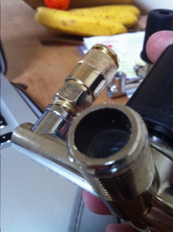

When changing tools etc the output valves stuck open,both have done it on and off.
no way to stop the air escaping ,if the tool won't go back in the valve.
Did it this week so i thought right take it off and have a look and maybe put a on/off valves in too.
Couldn't find any thing obvious so fitted it back in the manifold,pop i heard ,b....cks ....

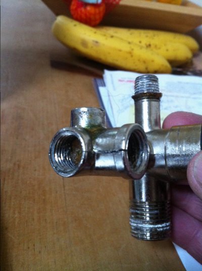

Had a look at the manifold and their was a crack right across the casting line. thought as id done it i would order another one .
It came and i fitted it all with on/off valves etc, switched it on and got some pressure in the tank and a leak,
this time from the tank connector put a nip on it and pop, the thread had cracked across the manifold there too.
Took the ally input pipe off to disconnect the pressure switch and the flare dropped off.
So now I've two bug...ed manifolds,!!!!!
A small ally pipe with no flare seal and no compressor.

Rang them up and they wanted photos so sent them off and got a phone call saying id over tightened them!!!!!
To be fair he offered to send me new parts, exchange the compressor or get my money back.
When i said i just want a compressor to work he said he'd think about it and cleared off.
My thoughts are why do they make parts with this monkey metal so thin on joints especially when its a hole and threaded area,and how much pressure do you, (not) have to use when tightening up air pressure connectors which run at 8 bar or so pressure.
