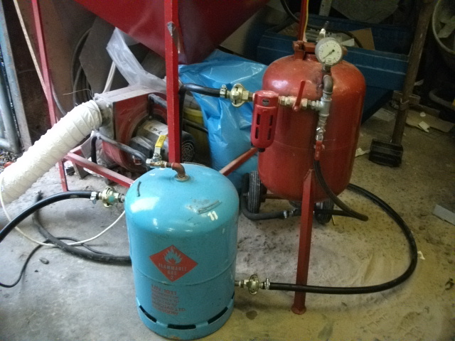

ive got one on both ends of mine and a cooling tank in between.if u have enough capacity i slightly leave the drain off on filter open and u can see the water eject i have no problems with water at the pot after the filterI have a good filter on my linked compressors and a long run of drained copper pipe before the outlet, with this in mind do I really need another filter on a blast pot??.
Cheers
ive got one on both ends of mine and a cooling tank in between.if u have enough capacity i slightly leave the drain off on filter open and u can see the water eject i have no problems with water at any point
