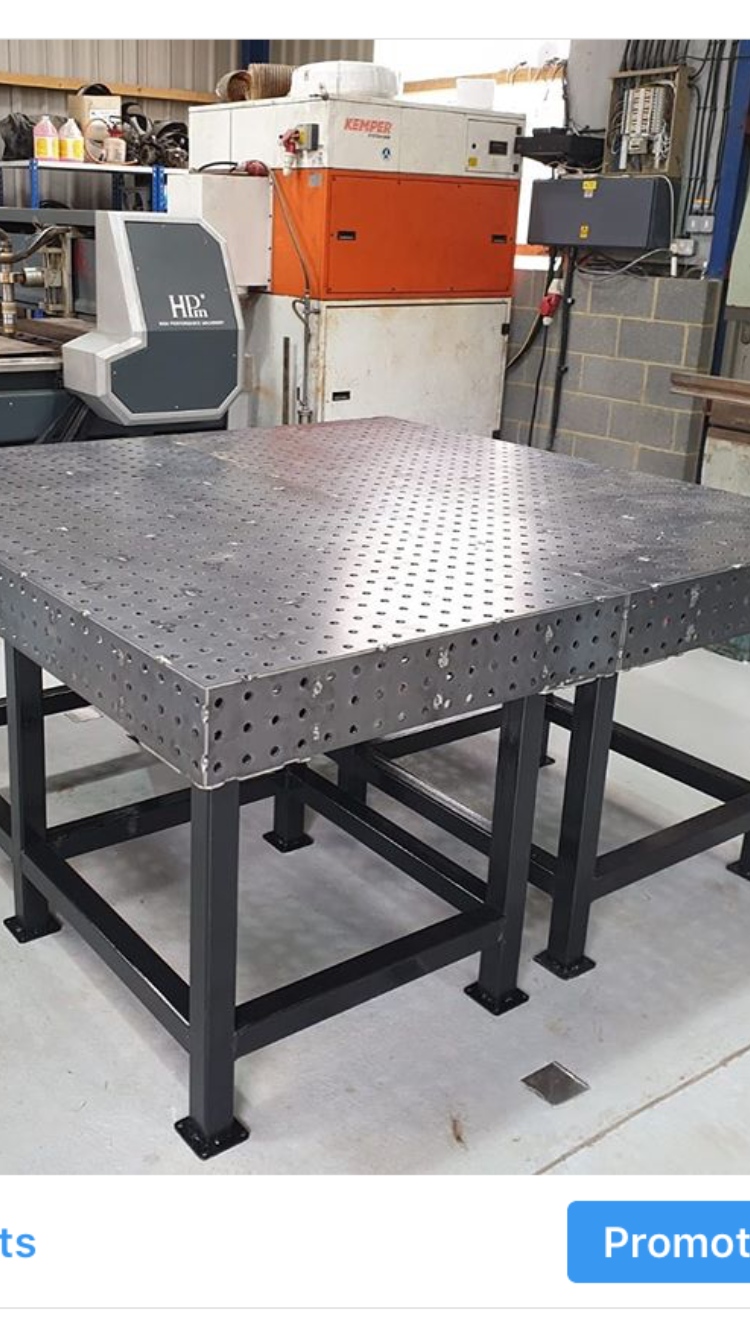

These are mine , Steve above had one at the same time as I had one cut out for a pal but mrs say no!
i bet there are members on here who could laser cut the table top for you then buy the box section your self then make oneWhat about getting the dxf files and sending them to be laser / plasma cut and build your own?

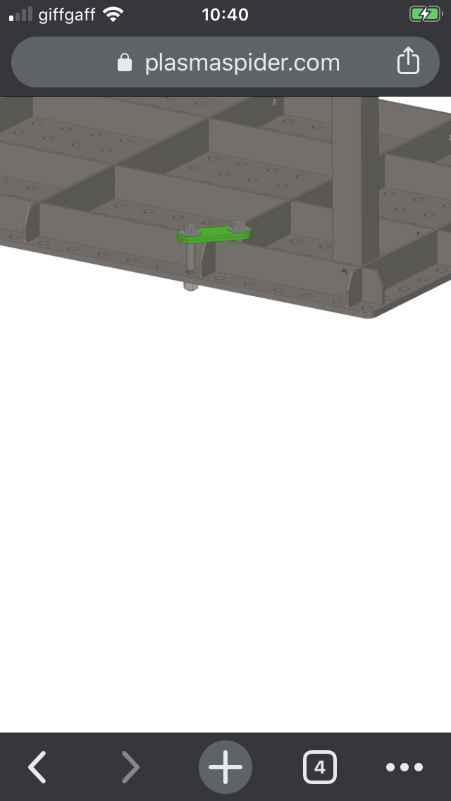

That's what I'm doing in this shutdown, I need a better welding table and although I've a cnc plasma, it's doing nothing to earn its money at the moment.
Files were free from plasmaspider with a few tooling files too, and I reckon I'll be into it for less than £200 in materials once it's done.
Just an idea.

I got the above table done for £600+vat so not badi bet there are members on here who could laser cut the table top for you then buy the box section your self then make one
