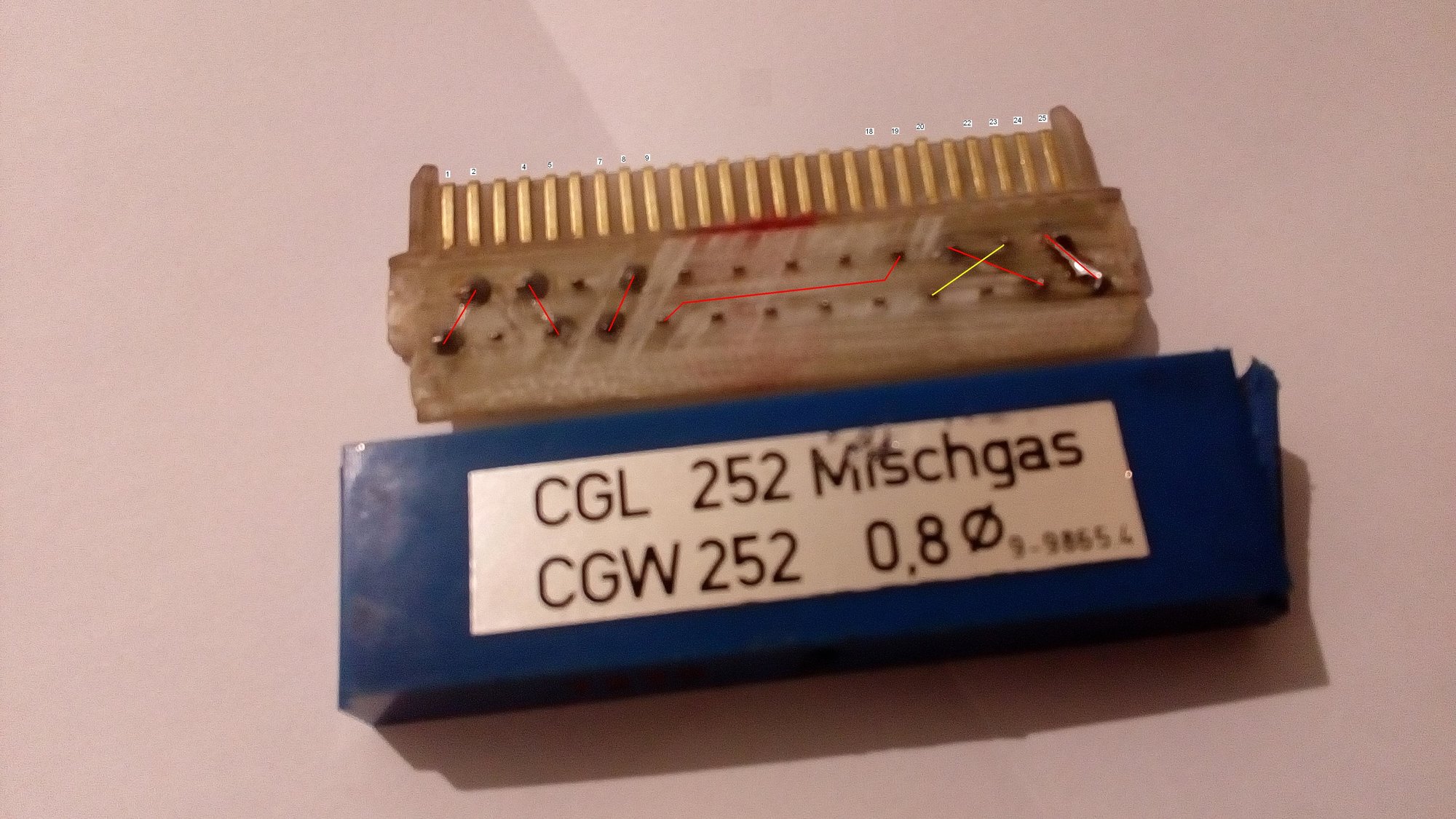

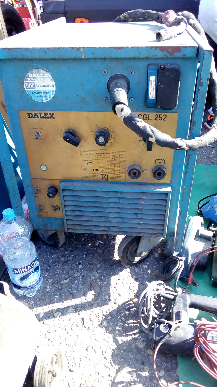

My friend bought the used DALEX CGL252,
On the front panel there is a module on which it says:
"CGL 252 Mischgas
CGW252 0.8 ø "
We have controlled the module with a multimeter, and it has only jumpers between pins:
1 - 2
4 - 5
7 - 8
9 - 18
19 - 22
20 - 23
24 - 25
We also opened the module for better viewing. (see image...)
Wire speed can not be adjusted because using this module is connected to the welding current and the wire speed increases as we increase the welding current, and the wire speed potentiometer does not change the wire speed at all.
We would like to use CO2 gas during welding, and want to control the speed of the wire.
Can anybody have a dalex with a 1.0 ø or 1.2 ø or a CO2 gas module to check with a multimeter connected between pins?
Thanks for your help..
