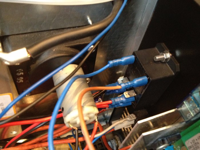

I have an old (ish) Cosmo 130 MIG that I bought in 2005, used once or twice and put it away until now!
Basically its almost in mint condition. It never really worked that well, overheating, wire feed etc. I thought I'd dig it out and give it a few of the mods I've read about on here.

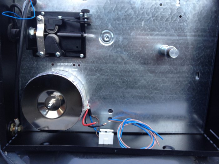

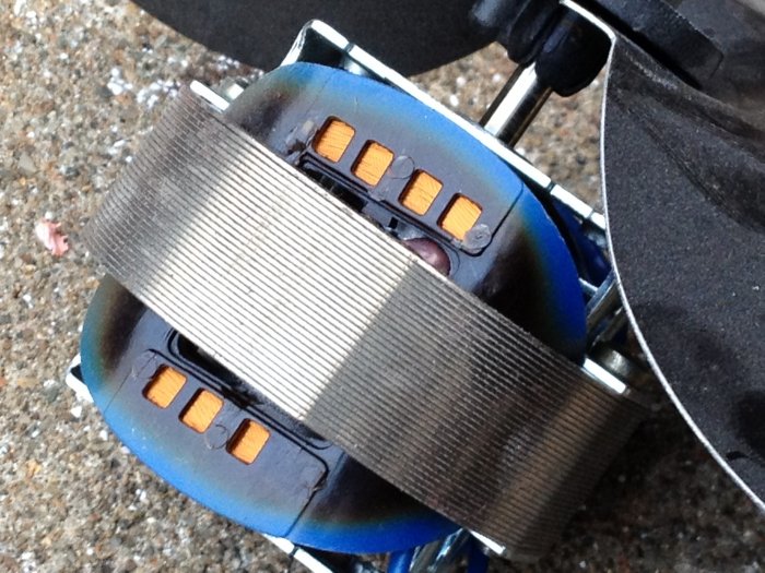

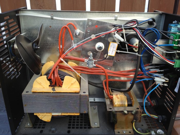

When I opened it up to have a look inside I discovered that the cooling fan was jammed against the main transformer!

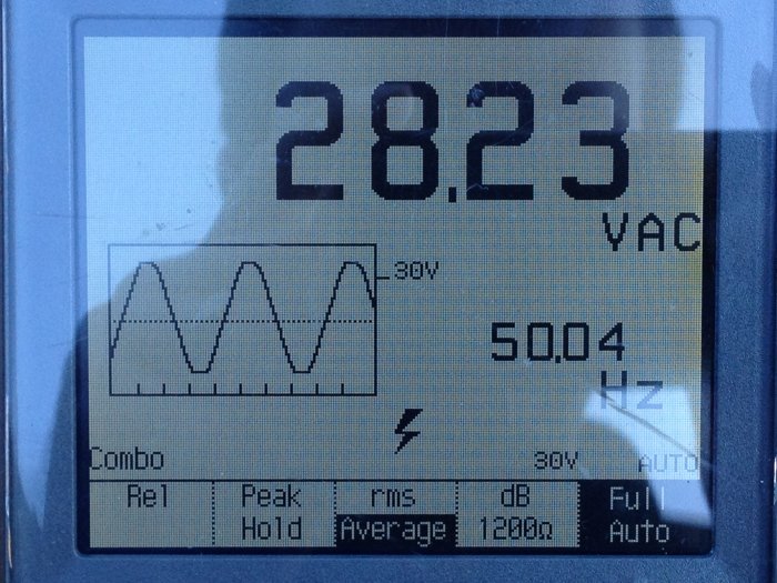

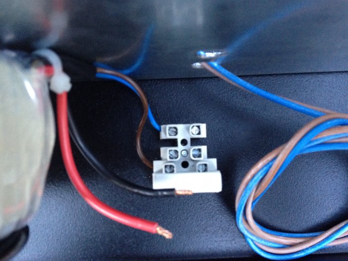

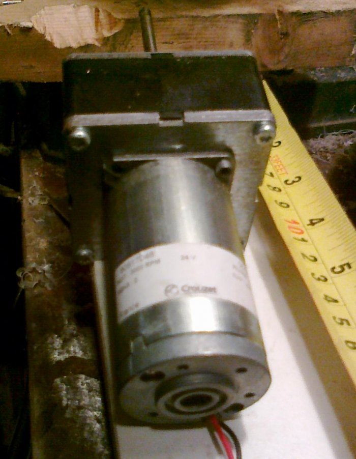

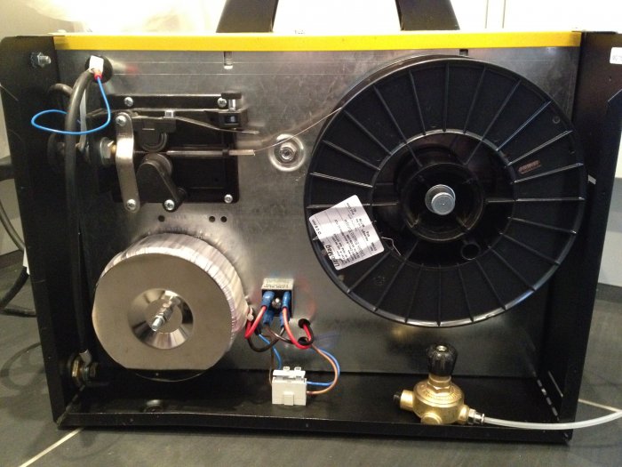

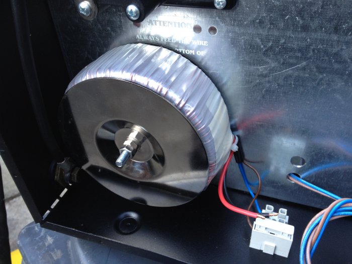

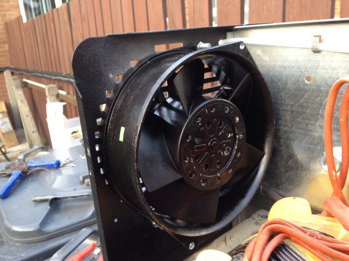

It had obviously had a good knock and bent the tranformer supports, that explains the constant overheating. The little fan motor had been pretty well cooked by being jammed so I decided to "mod" it a bit. See below!

, toroidals used to come with a pair of rubber discs to fit either side when clamping.
