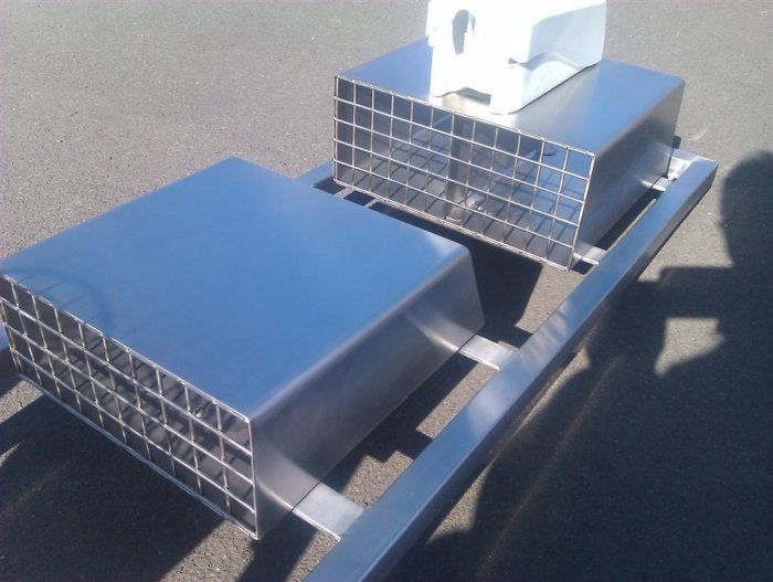

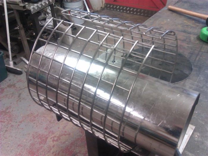

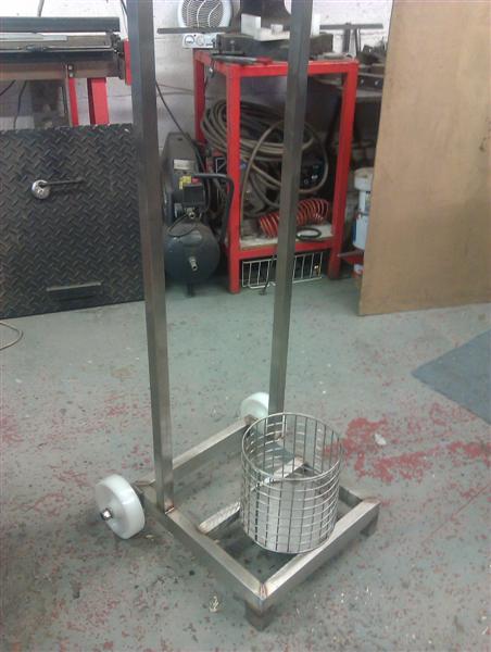

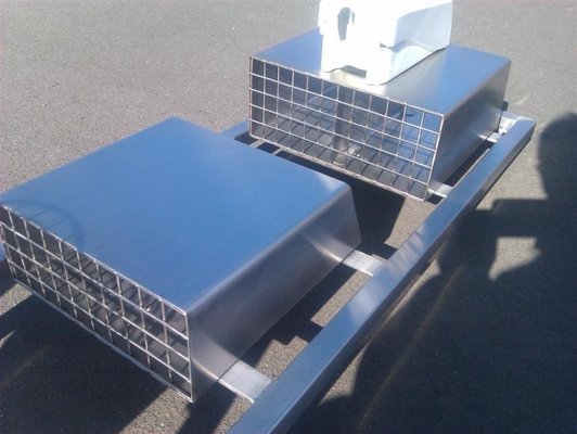

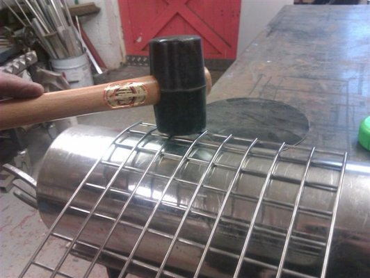

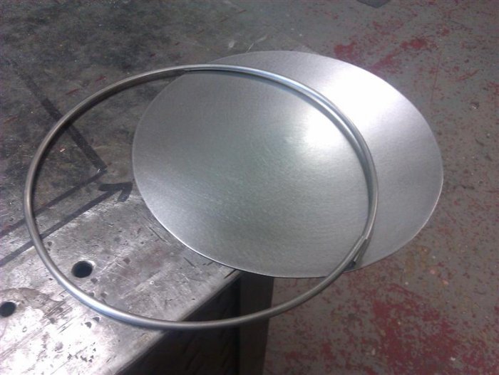

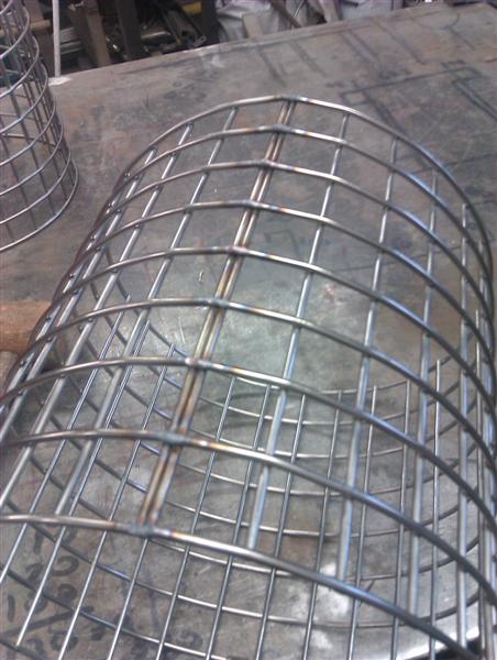

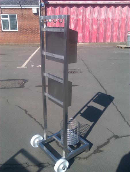

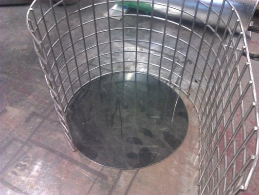

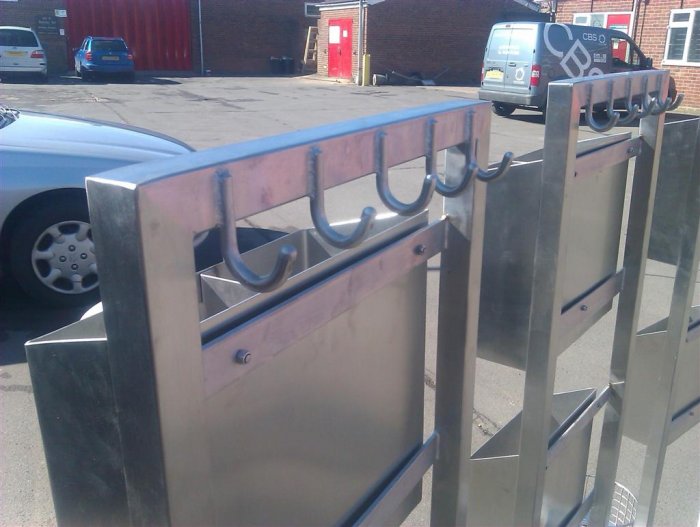

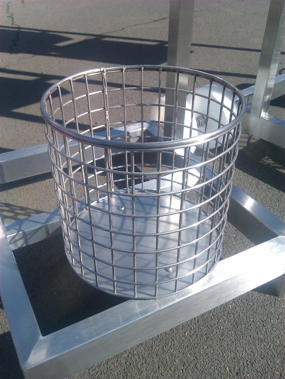

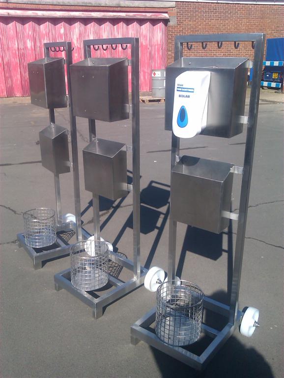

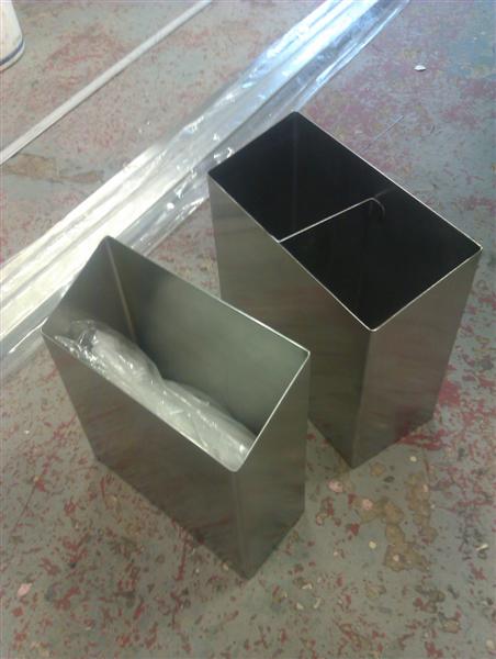

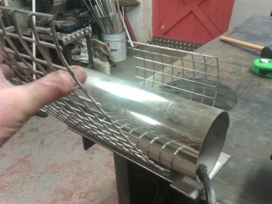

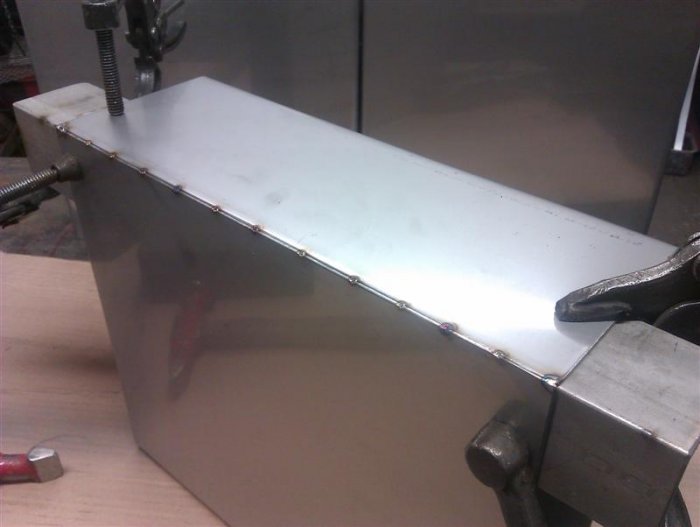

3 off mobile stands for cleaners to use when sanitising food production machinery,

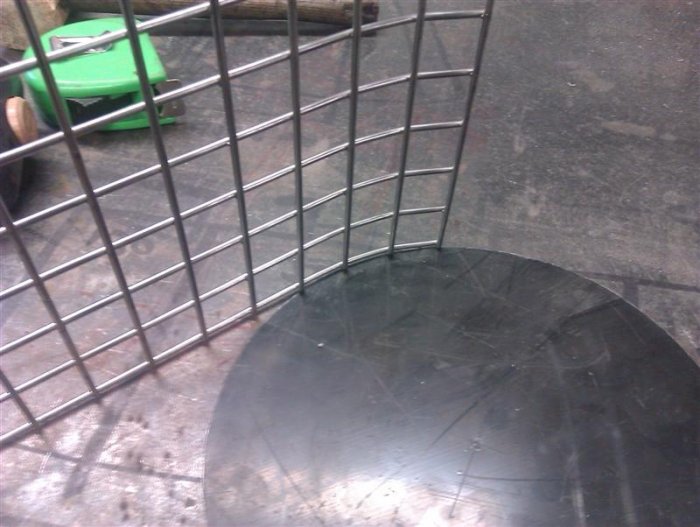

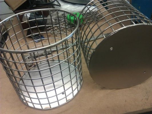

The basket on the base is to contain a roll of alcohol impregnated wipes, these come in a polythene bag so just drop it in slit the top and they pull from the centre of the roll

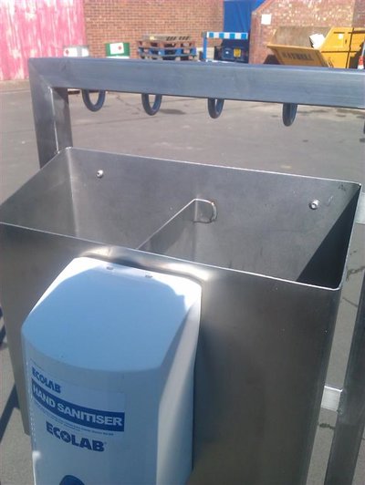

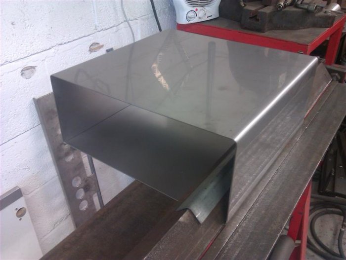

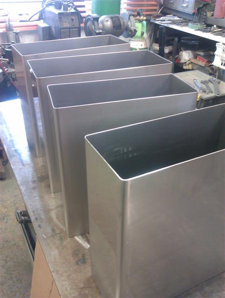

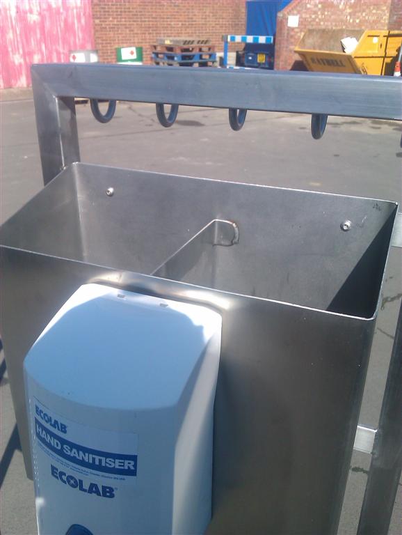

Top box is divided down the centre to store armlets (protective sleeves) and gloves, hand sanitising dispenser mounted on the front, the lower box is to store disposable paper coats, both boxes have mesh bases to allow easy cleaning.

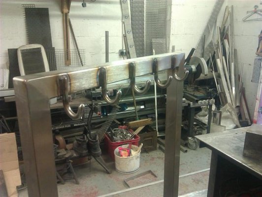

Hooks on the back to store polythene aprons.
