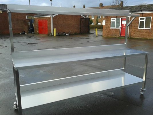

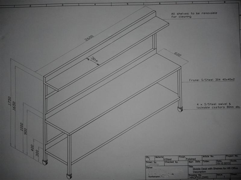

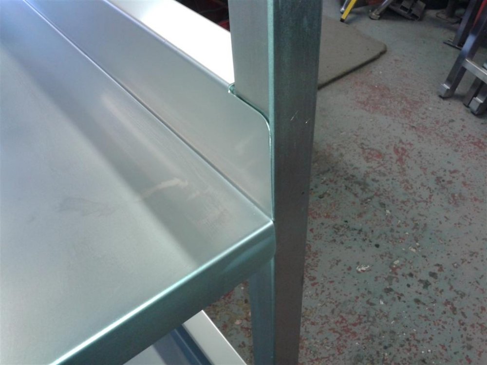

Another one finished today, a mobile desk to be used in a food factory office, it will have computers, label printers and scales on it so needs to be of sturdy construction and has to strip down for cleaning, I actually got a sketch from the customer for this one for a change, no manufacturing detail though just a picture with a few measurements on it, still its better than nothing, I usually have to guess what they want.

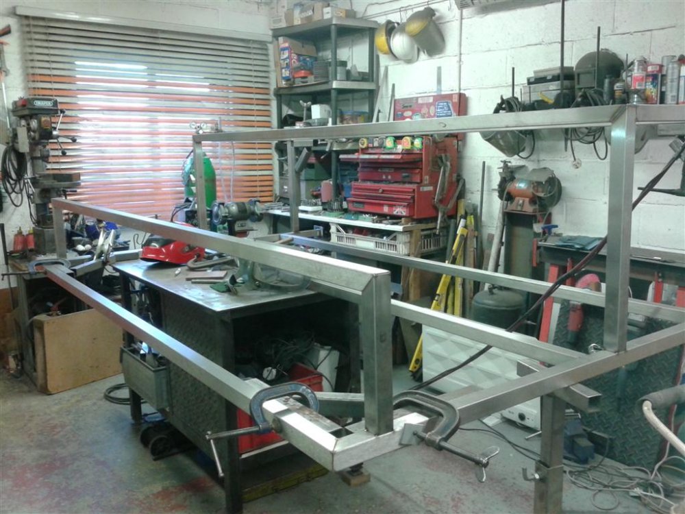

Fabbing it up, could really do with a bigger bench, about three hours or so after this picture was taken and it was all welded up got a phone call, "er sorry it needs to be 2500 long not 2600", thank gawd for thin cutting discs.

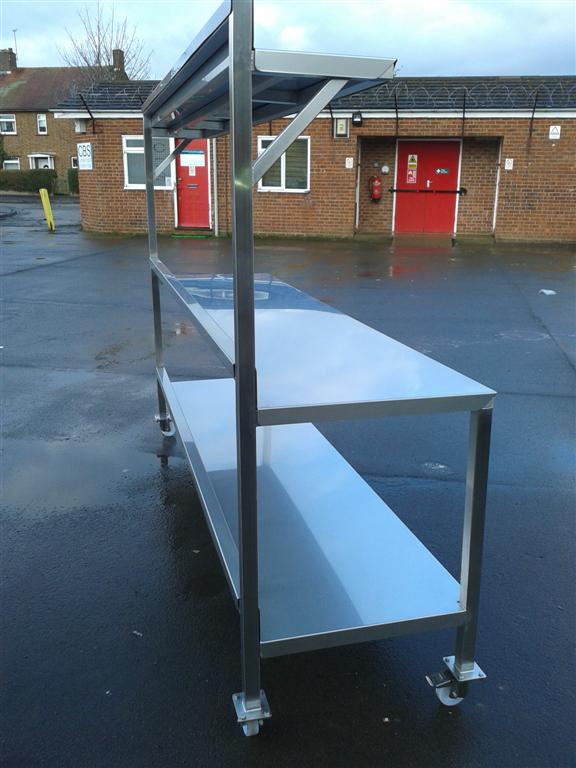

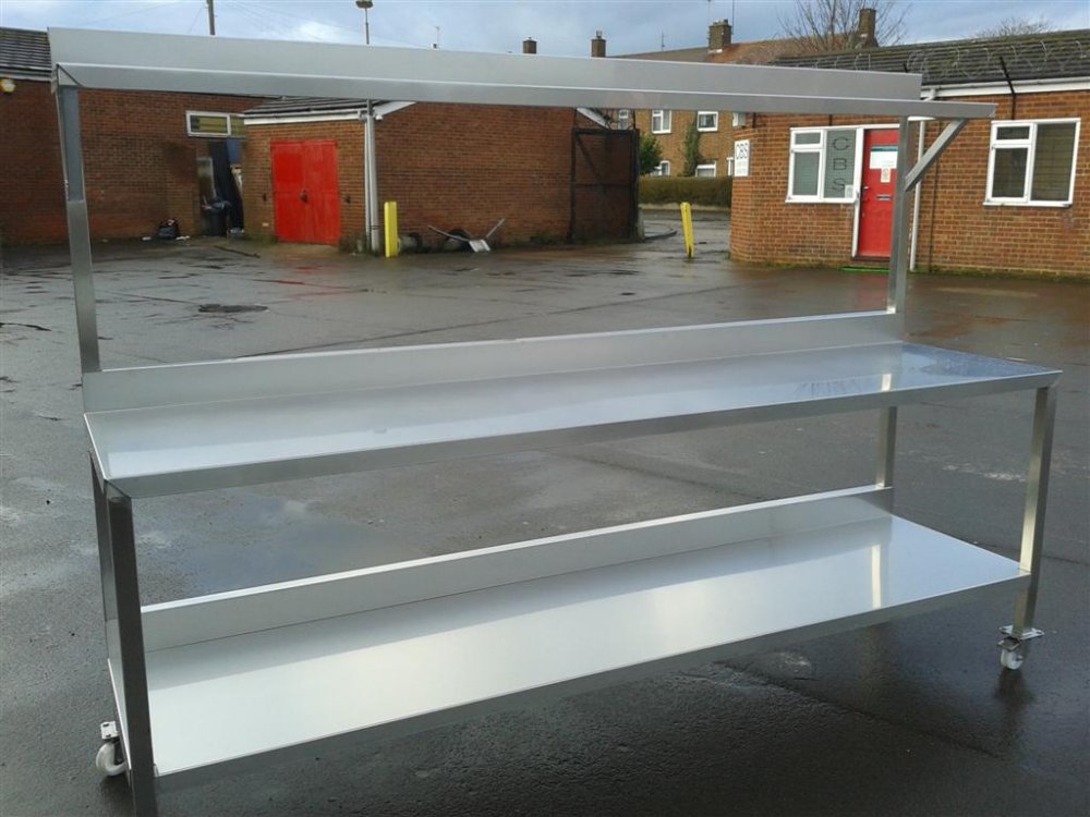

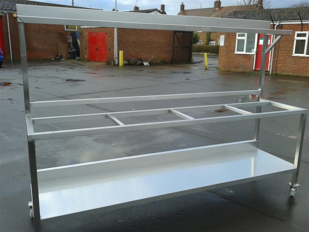

Finished here and shown without one of the shelves,
Top is folded all round to hold it in place and notched round the frame
Job finished
