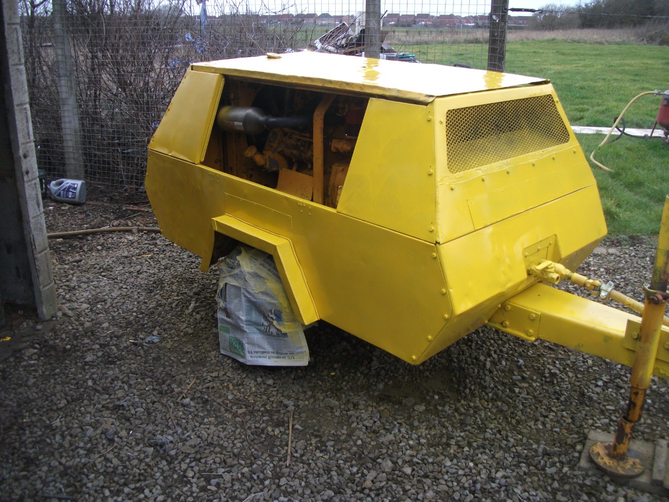

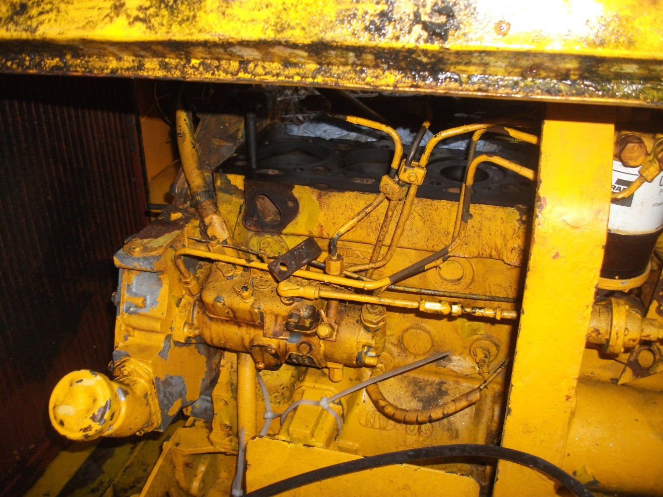

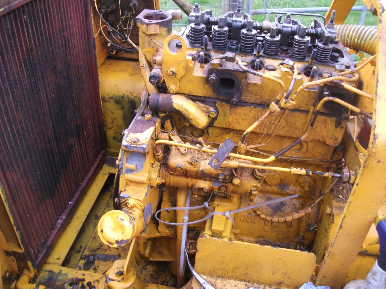

bought it for 75 quid and it was overheating
took the head off thinkin it was the head gasket. looked inside and the bores and valves were like new so put it back together and found out the radiator was kacked up with dirt that couldnt be seen as the oil radiator and water one are bolted together cleaned it out and it runs perfectly
last time out it didnt want to start when it was hot
just drained the fuel tank and filters bled the system that had rust and water in it . starts and runs fine now not bad seing as though it was built in 1936 and was only used as a standby comp
