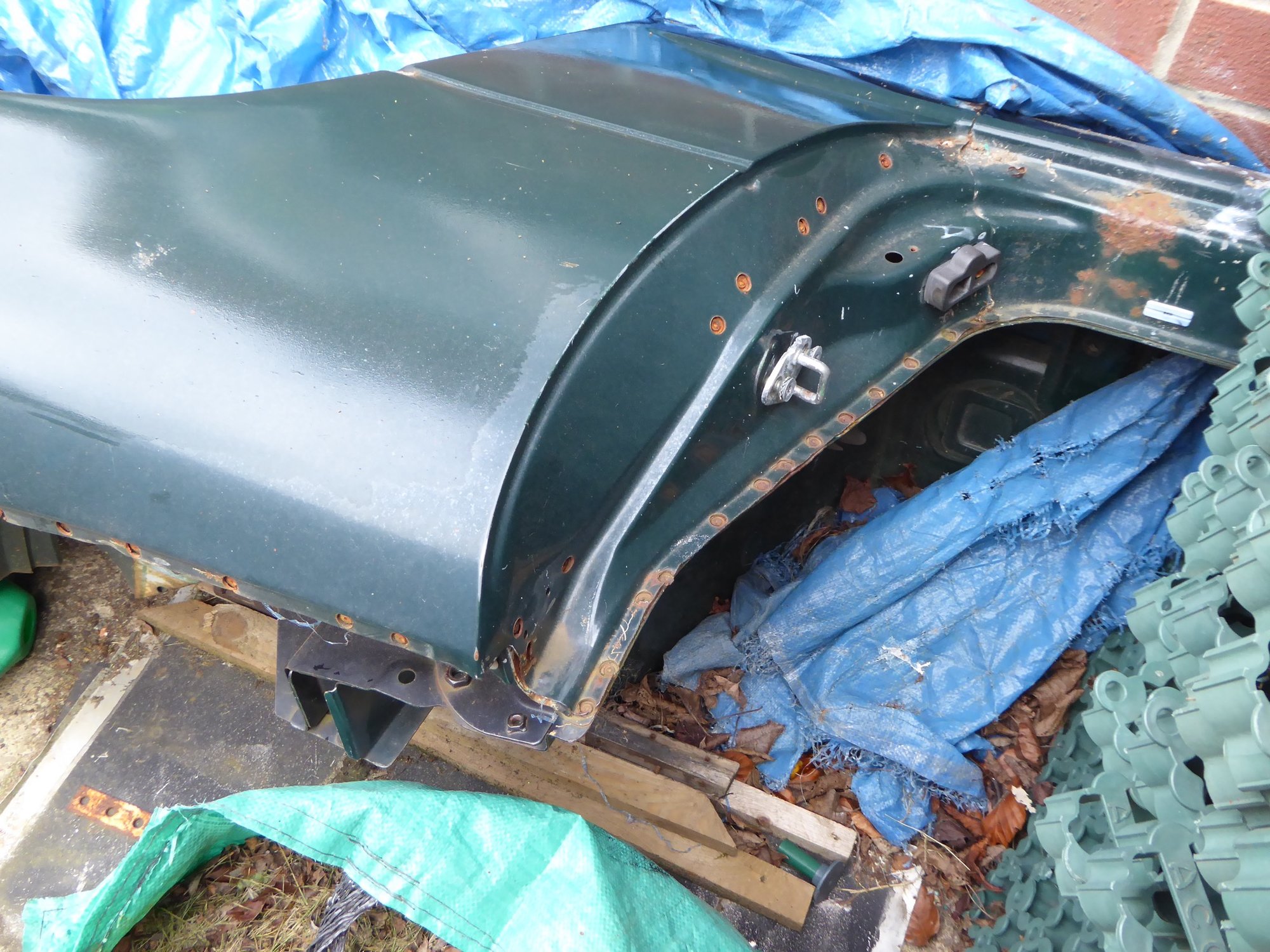

Any thoughts please?

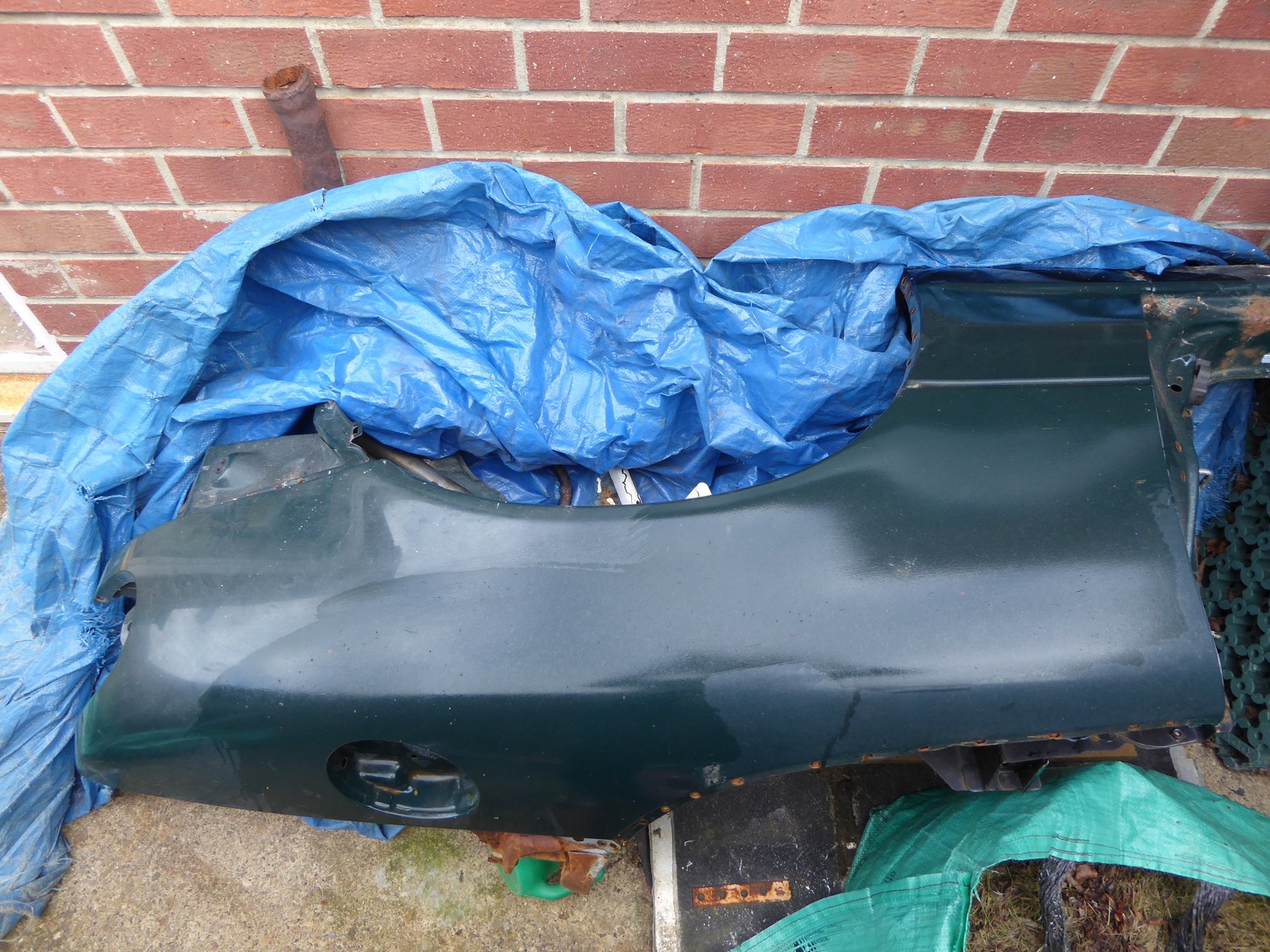

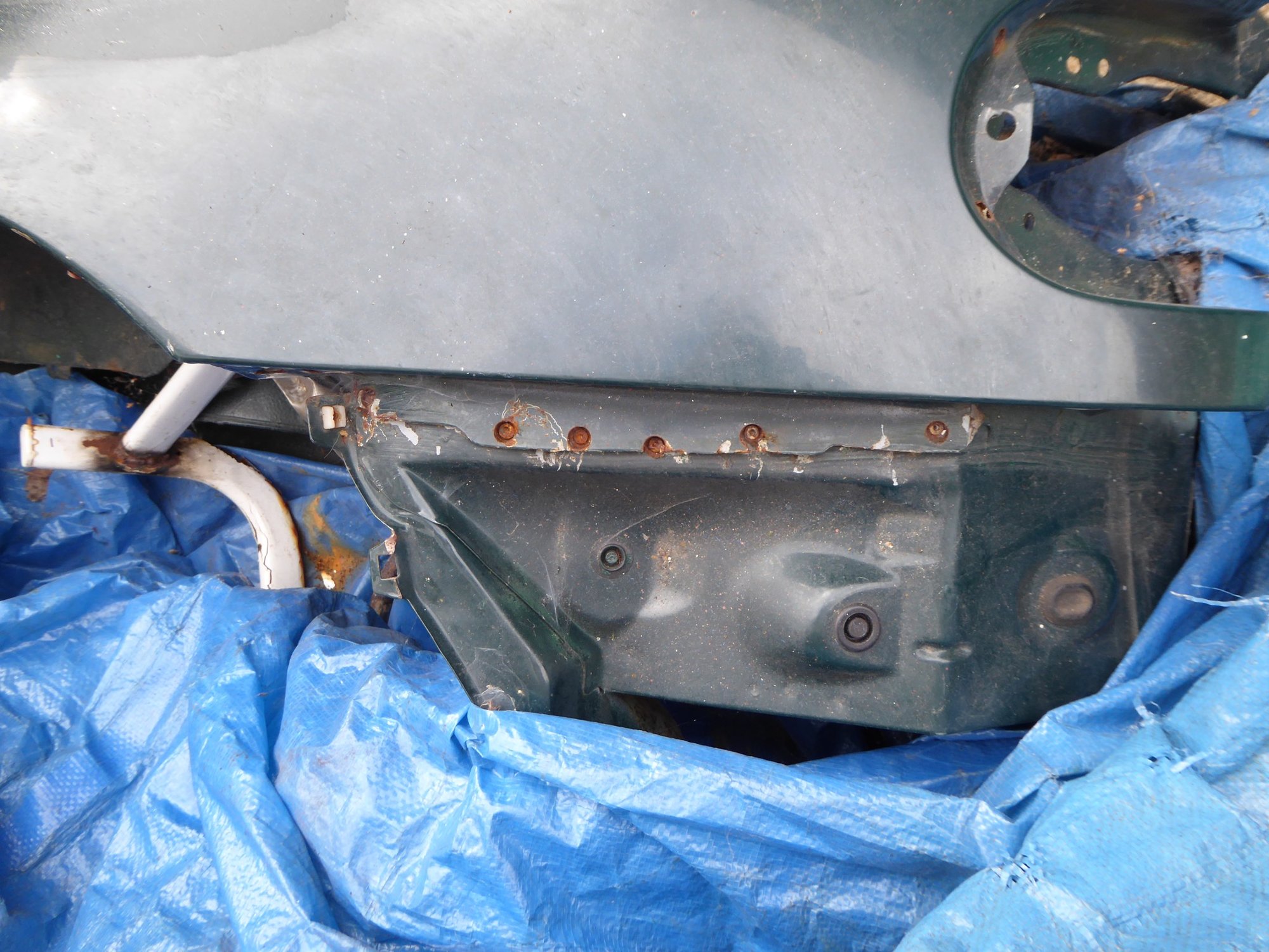

Ive used a pry bar, after using a zipcut on the welds & they all appear to be free. The panel seems to be still tethered in the middle of the panel, if there are more spot welds they’re very well hidden. Had hoped somebody on the forum might have already removed one.Sometimes you don't get all the weld with the drill bit so a chisel will be required, if you can't see spot weld sand the area and it will often reveal them
