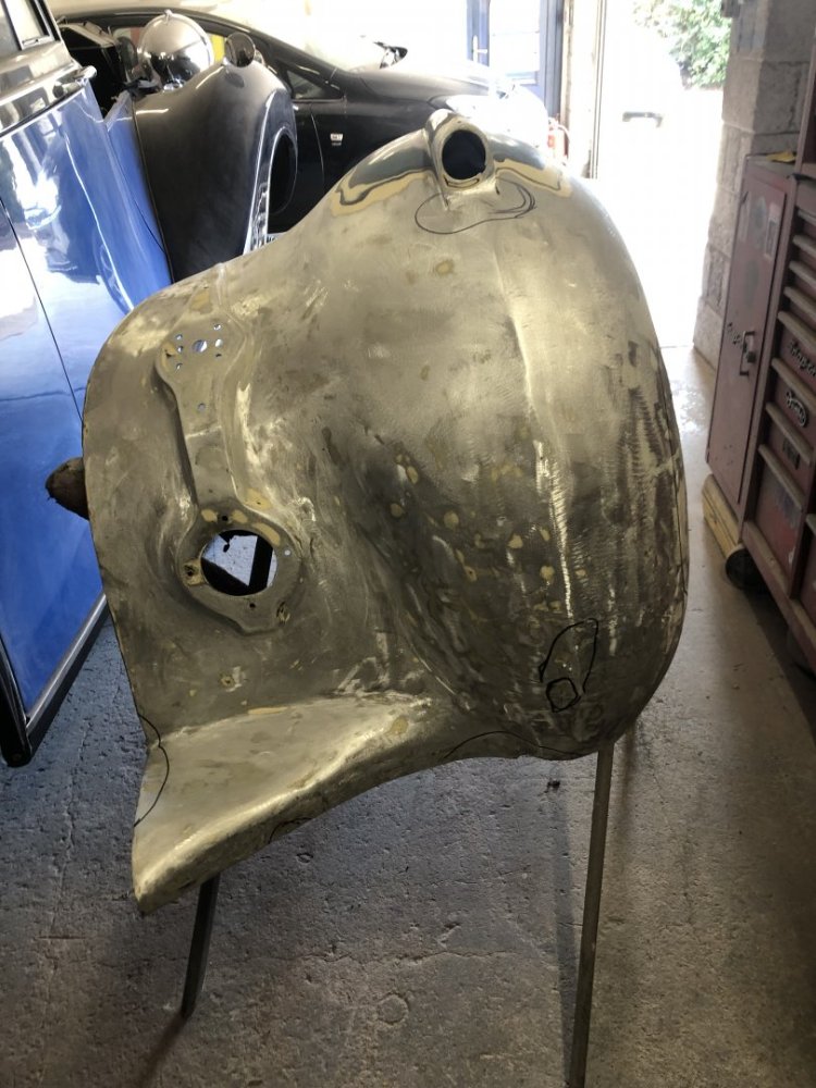

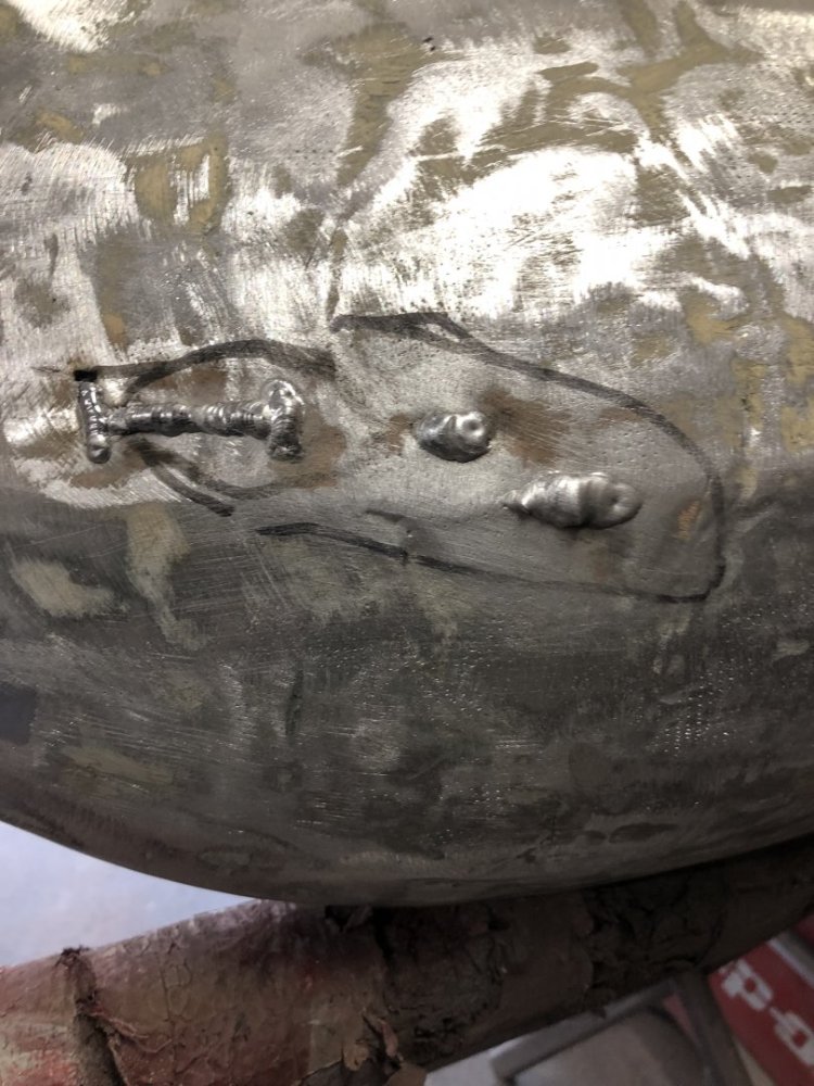

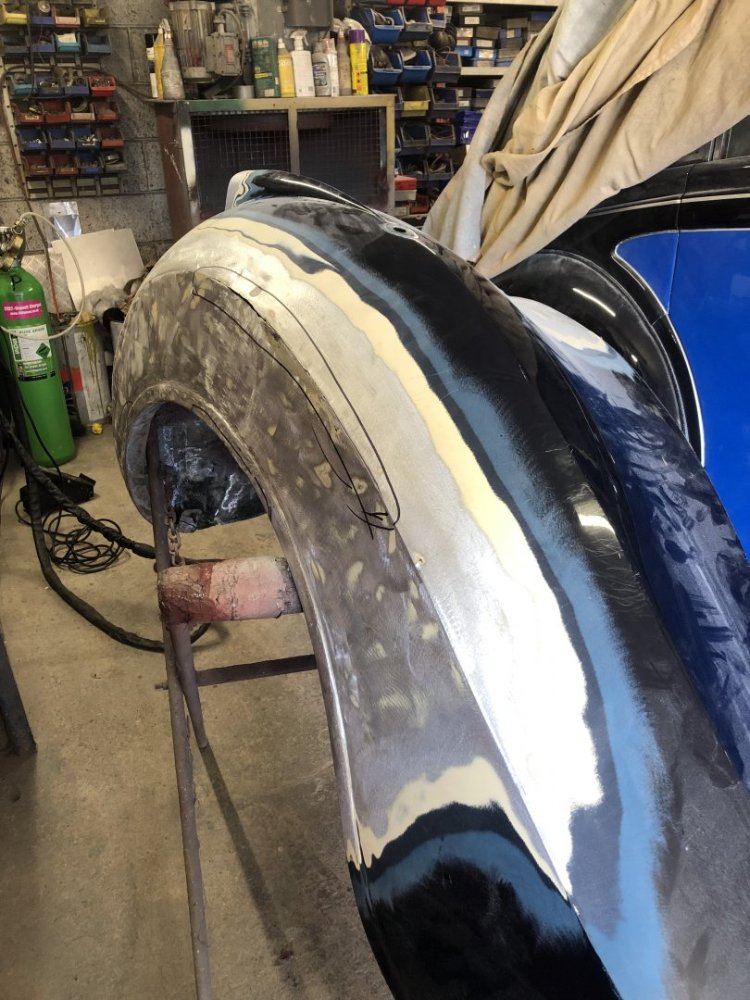

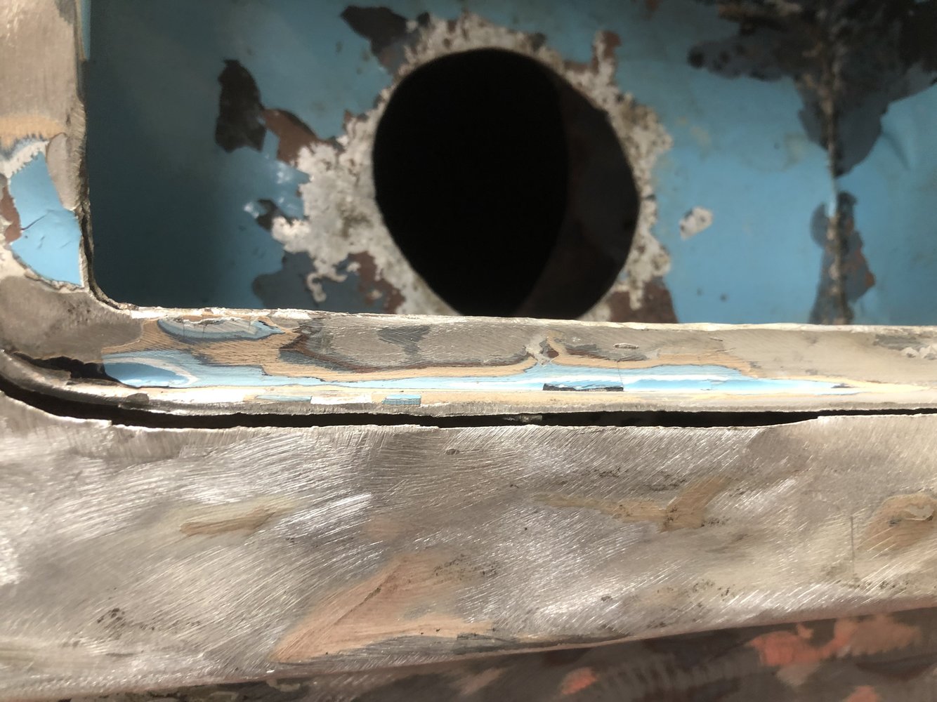

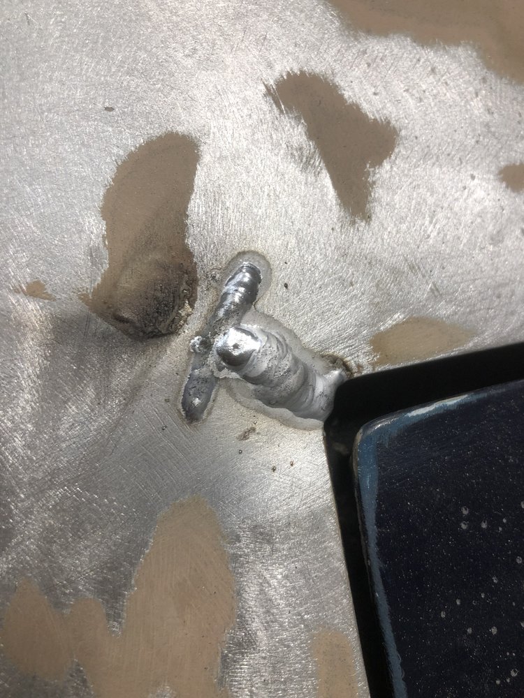

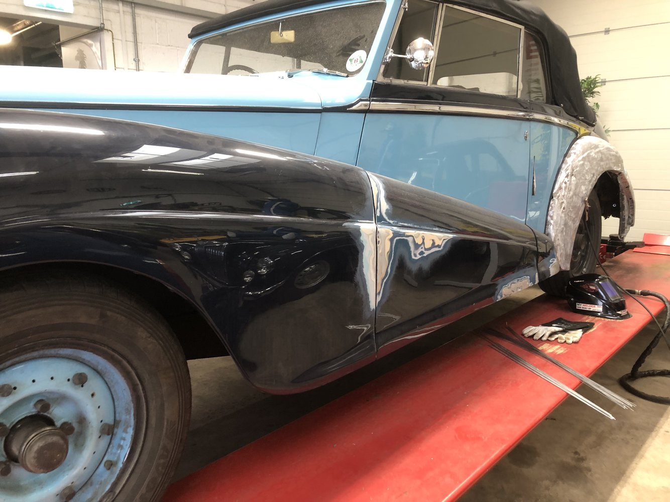

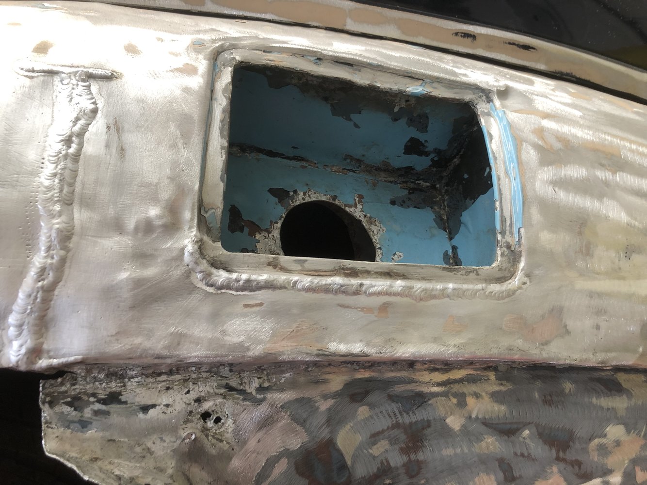

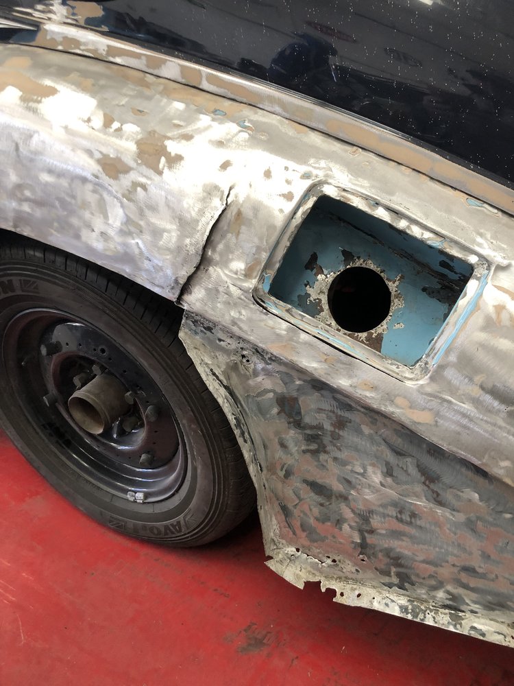

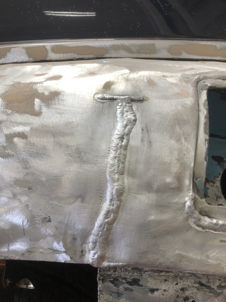

I was asked if I could sort out cracks and long tear to the rear alloy wing and rear alloy back panel below the boot. Toss of a coin, MIG or TIG? I went with tig, some areas difficult due to being wafer thin, heat sinks required at these areas.
Be a nice motor when restored, not many of this type manufactured.
