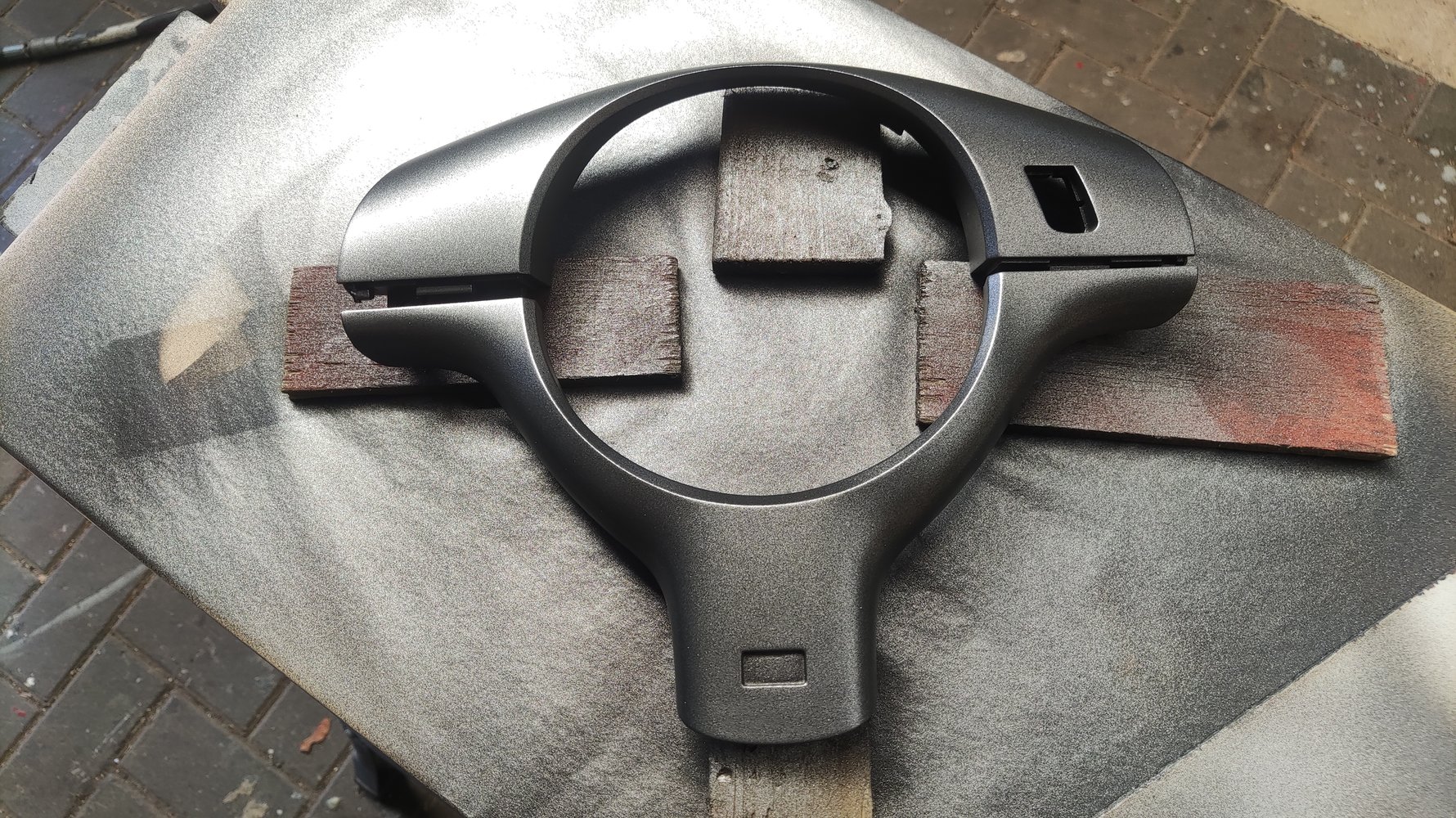

I have some Mipa Multi Matt that I want to use in clear coat to achieve a Matt finish.
I am having trouble understanding the mixing ratio as I haven't ever used it before I have no idea.

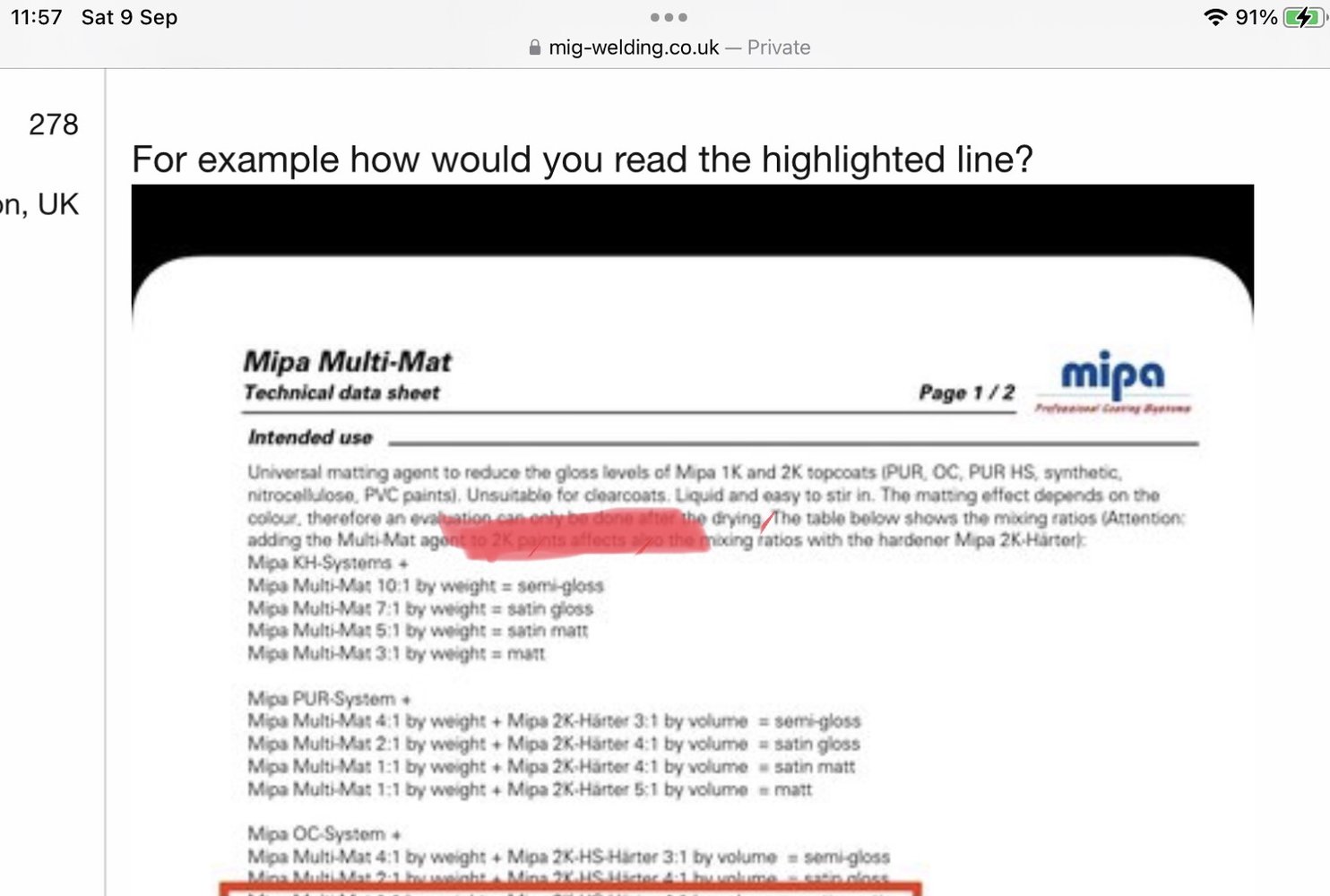

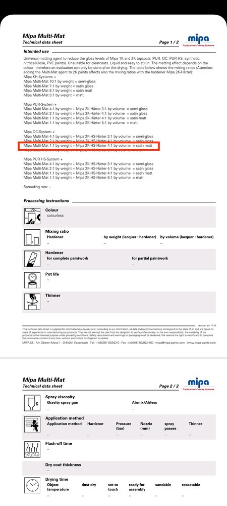

For example how would you read the highlighted line?
Is it Multimat 1:1 with clear and then that mixed 4:1 with hardener?
I am not using Mipa clear coat, so there is going to be some experimentation needed!!
Thanks
