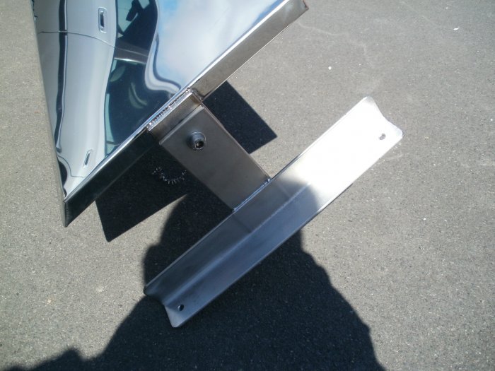

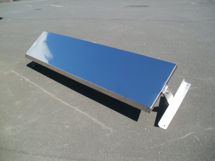

One of this weeks jobs, 3 off these stainless steel mirrors, will be mounted on a wall over a conveyor so that the operators can monitor the process from one position, made from 18swg, (1.2mm) sheet with adjustable brackets from 50 x 50 angle, they are bigger than the photo makes them appear, 1300mm long x 300 wide
