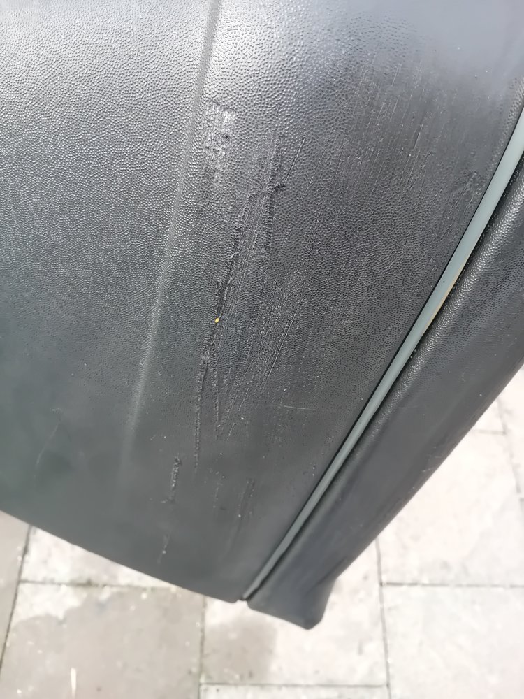

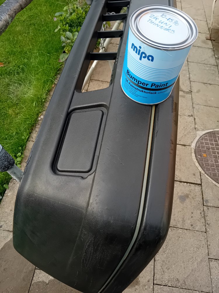

vw1 Member Messages 1,093 Location solihull uk Oct 4, 2024 #1 Never used this but supplier said mix 10-15% uni thinners and spray directly to bumper. Some areas of the bumper have scuffs so I assume I go through the grades to smooth them out ? It's a textured finish I have been told and thats fine. Advice as usual is most welcome. Thanks in advance.
pedrobedro Man at Matalan Messages 13,152 Location CX near Chesterfield Oct 4, 2024 #2 I "retextured" my bumper on the van I had with a hot air gun. I melted the graze and pressed some 40 grit onto it then pulled it back off. I didn't bother painting it.
vw1 Member Messages 1,093 Location solihull uk Oct 5, 2024 #3 I say textured but it's not like stone chip gard etc it's much finer I believe.
