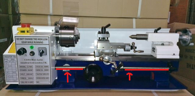

i have a problem when winding the carrage back ad forth, in places it catchs on the long threaded bar that is used for the feed, how could i adjust it so that it dont catch ?? its as though its catching the tops of the threads in places,
im prity sure its catching on the threaded bar ,, when it catches , if you look closely you can see the bar flex downwards then spring up again as soon as frees up.
i think it may be the problem ,, im new to lathes, never had one or used one, with the lever down it feeds the carrage fine, but when i lift the lever up i dont think its clearing the tops of the threads enough,
