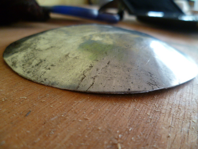

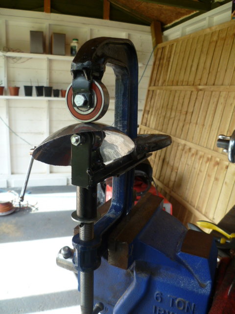

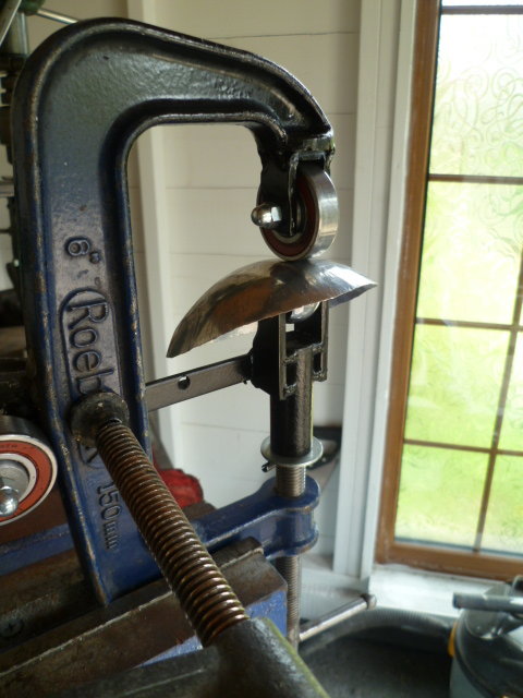

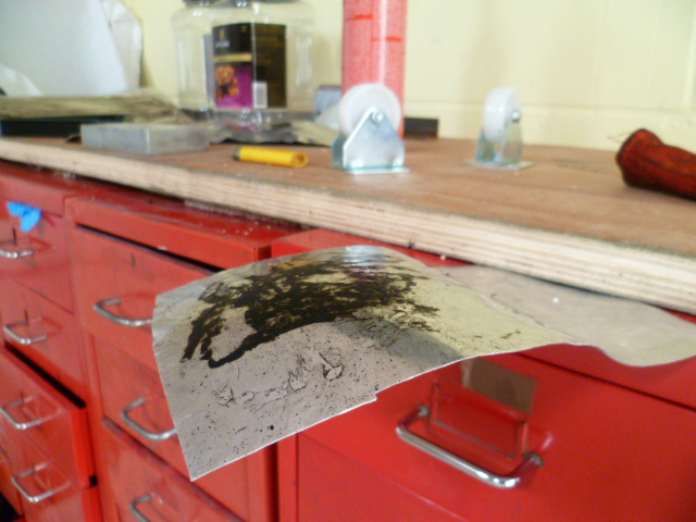

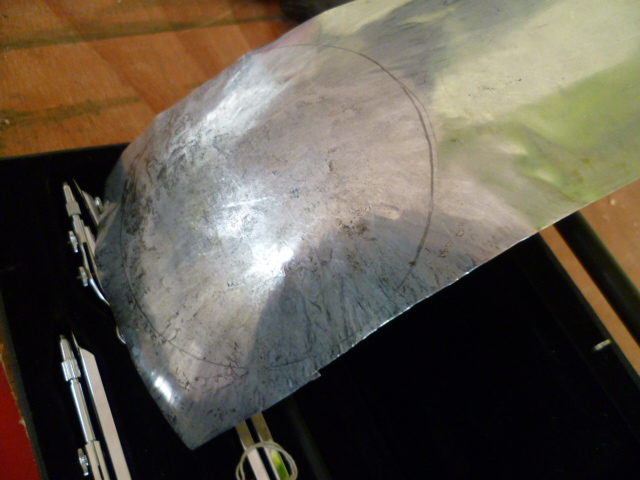

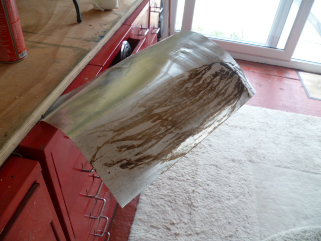

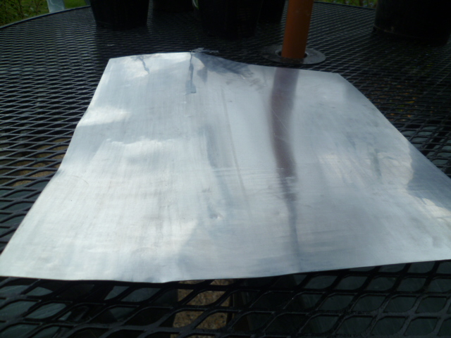

I have upgraded the mini wheeling machine with new bearings and re profiled rollers and gave it a shake down to see what it could do. It's handy for very small stuff.

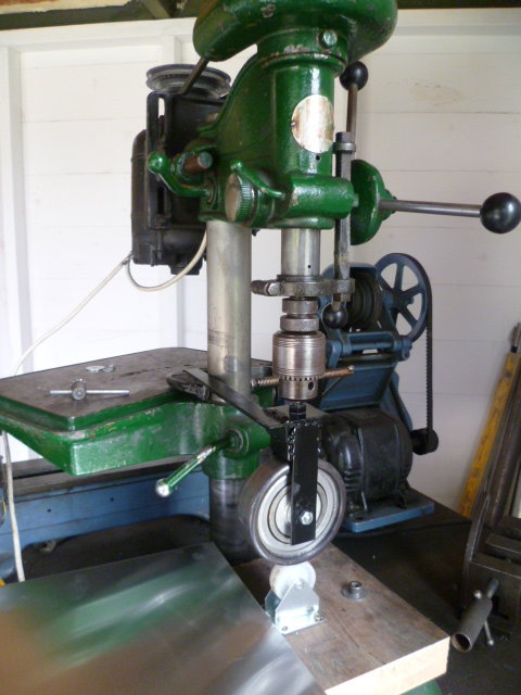

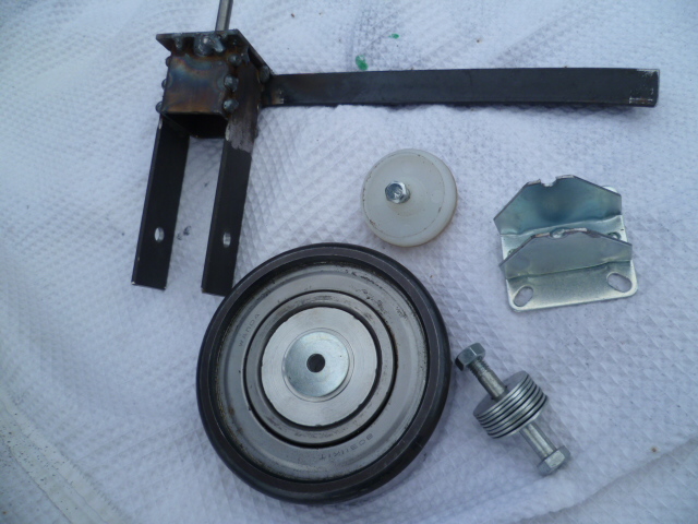

Another trial this time with slightly larger diameter rollers and an old carriage roller from the mast of a forklift truck. The nylon rollers were re profiled in the lathe and have yet to be tried, not sure if they will work correctly.
