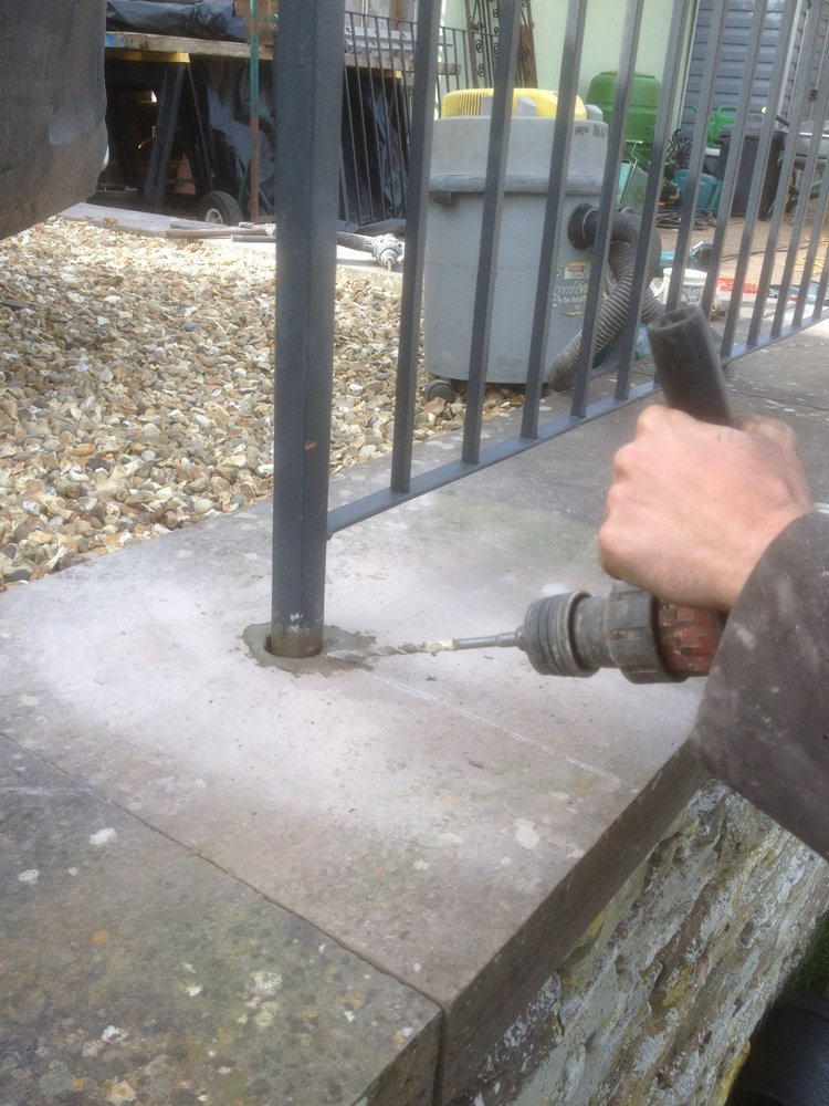

pretty dangerous using lead .specially if the base is damp and it explodes .resins are more suitable and easy to useIs there a reason why they are no longer set using molten lead?
fumes from melting the lead to pour it into the hole is the reasonIs there a reason why they are no longer set using molten lead?
with the sds drills nowadays they can be done without having water or it being damp inside of the holes for the leading purposepretty dangerous using lead .specially if the base is damp and it explodes .resins are more suitable and easy to use
We use this at work with no issuesI just squirt colle chimique in (resin glue?), job done!
Exactly,I use quick set cement,probably 4 x 10 kg buckets a year.Would it not be better using a dry powder mix and just add water Nick? that way you could use a cane and cram it right in.
Would be my choice too.I just squirt colle chimique in (resin glue?), job done!
