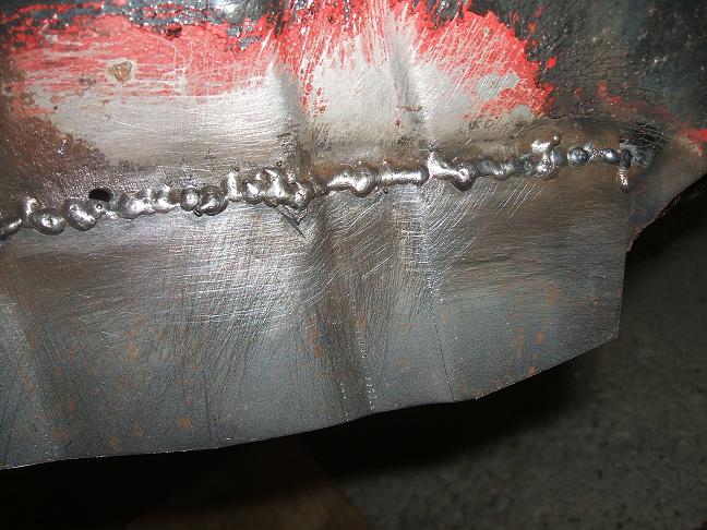

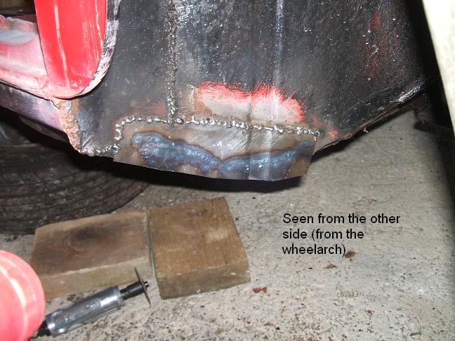

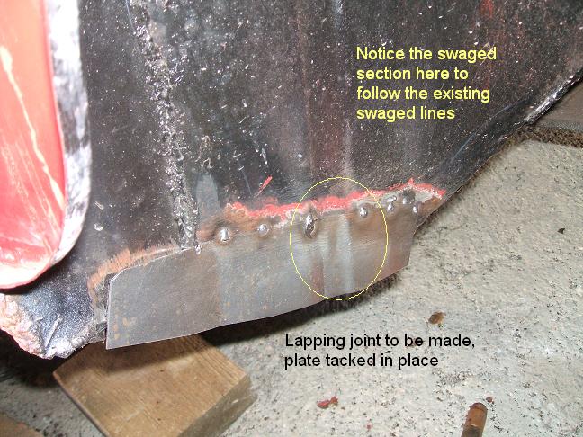

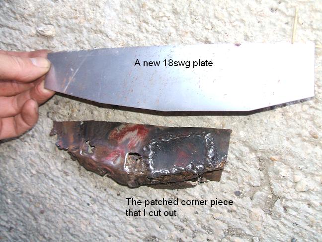

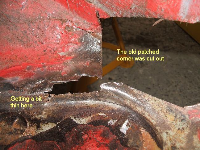

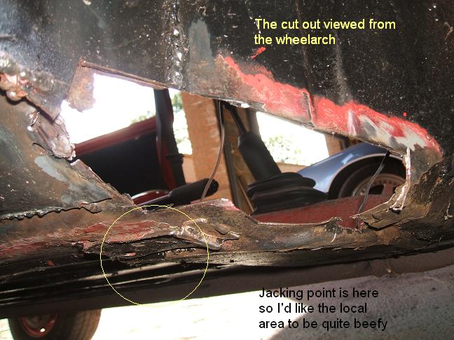

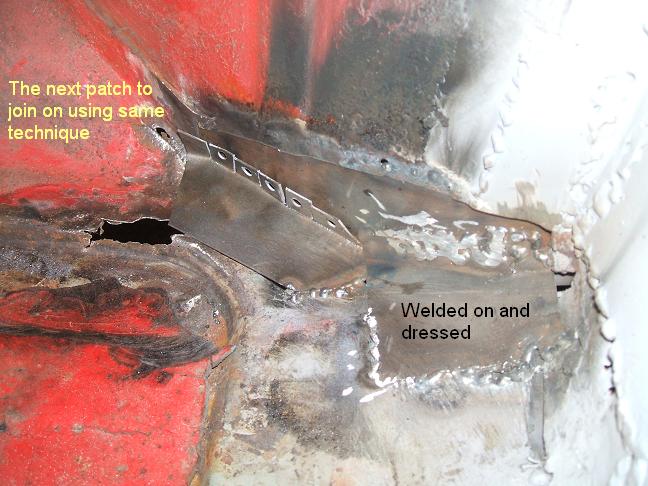

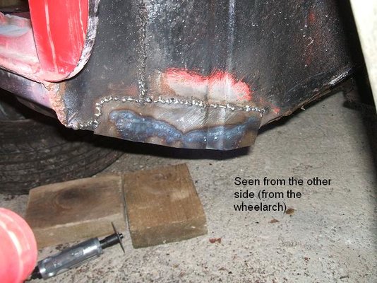

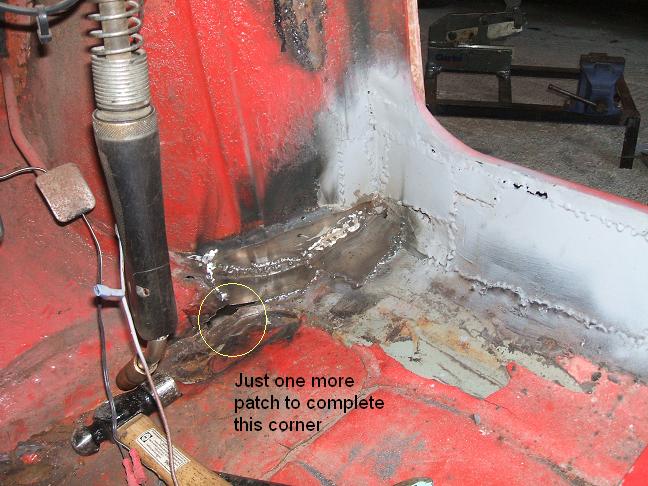

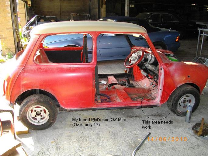

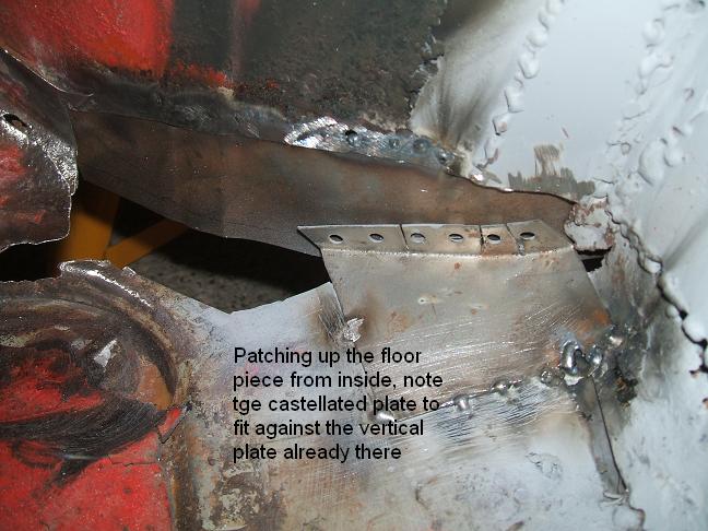

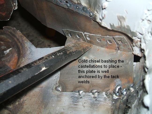

I've not posted something here for a long time. Here's another one of my projects, this time for a friend Oz. The Mini has a few patched repairs like I'd have done, but the welds are messier than I'd have done. I hence chopped out one offending area to remake it. See what you think.

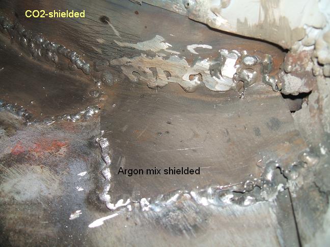

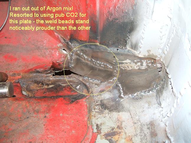

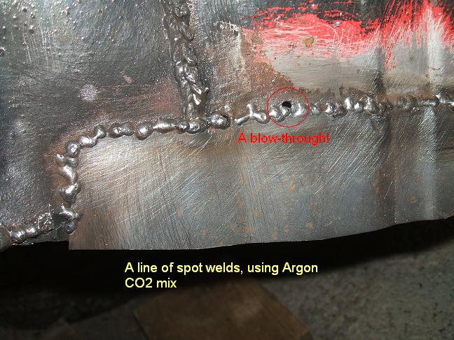

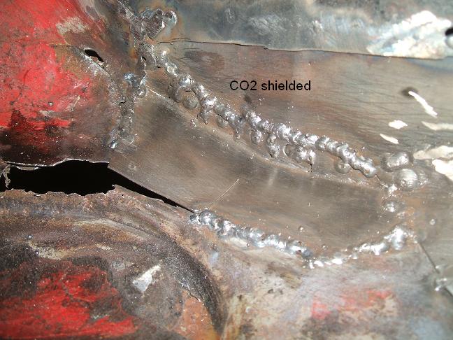

Out of interest, I started this out using Ar/CO2 mix, and the weld beads are pretty flat. This ran out and I resorted to my old CO2 pub bottle. The welding is actually as easy to do, but the weld beads stands a lot prouder, needing more grinding down.
