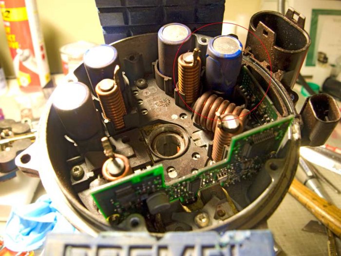

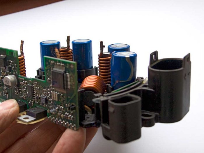

Common fault on 1st generation BMW MINI electric power steering pumps - dust from the brushes finds its way into and onto the controller board and causes the pump to fail. Stripped it down and found the blue plastic coating coming away from whatever that is in the pics. Is this of concern and if it is, suggestions for a remedy would be much appreciated.
