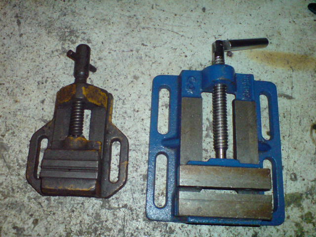

Could you write me a list of everything I need to buy for that thankswhen I first got my hobbymat lathe , and came with a drill vice as standard for doing milling with, and shown next to a 3" clarke drill vice (which gets used on a drill and not my milling machine.

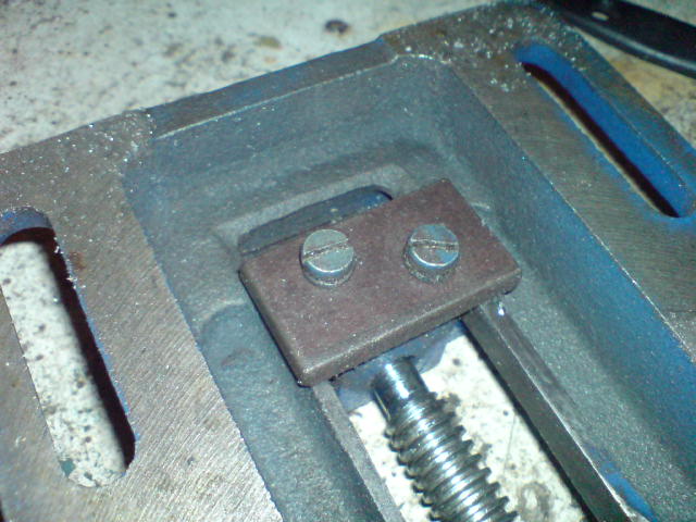

the plate that holds the moving jaw down is too thin and will bend, I replaced my with some 6mm thick steel bar.
you'll be fine if you take light cuts and dont expect it to be too accurate you'll be fine, as they arn't made to any tolerance. I couldnt find a vice that I liked so ended up making my own
