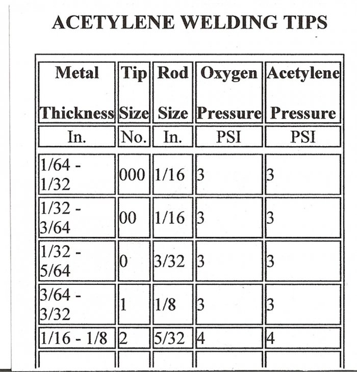

hi, oxt/acet how do i reduce the problem of mini explosions in the weld being done, what are the gauge pressures for different nozzles ie 1,2, 13, etc and the pressures for cutting regards wukkie1
when it happens it blows the weld pool in all directions . if the welding is getting 2 hot and emitting sparks the sparks can get up the tip of the torch .if its getting 2 hot the heat reflected back on the tip can cause it to pop at low velocity. this causes gas to explode
