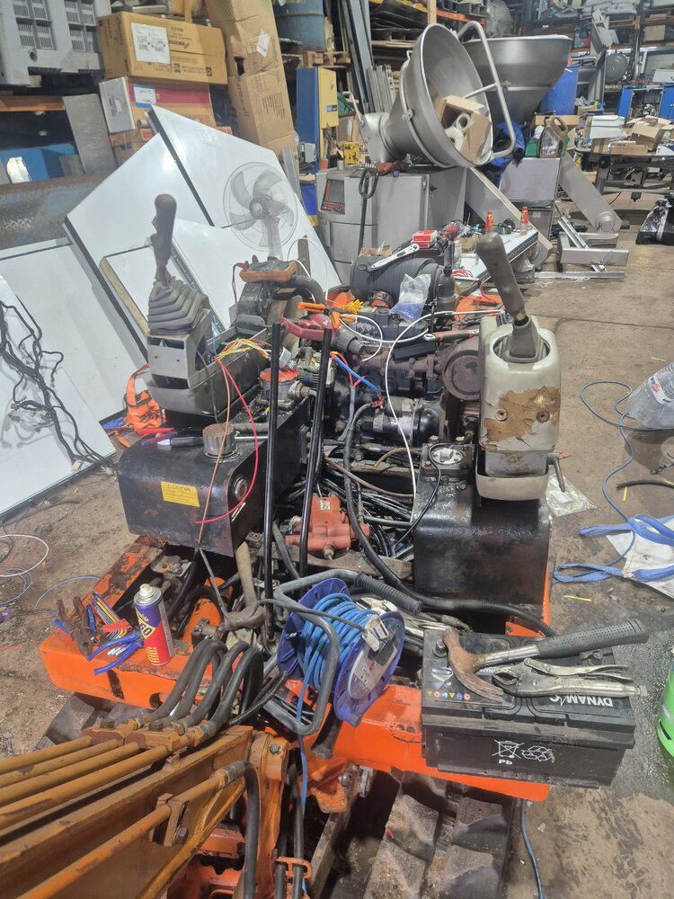

Parked my mini digger up for about a year, went to use it... drove fine but no other hydraulics working
Stripped it right down, found a broken wire to a solonoid.. fixed that... digger working again!
But looking at it, wiring was a total mess, it had been bodged a lot, lots of solid core wire which is obviously going to break over time
Decided full rewire so ripped all the old stuff out, almost finished now
But... there's 3 hydraulic solonoids down deep in it, I assumed theyre on/off with ignition power and the safety switch in the arm rest...
Now I'm wondering... is that right? They'll be powered on constantly when engine is on and arm wrest is down?
Theres safety switches built into both hydraulic joysticks but they'd both already been bypassed
