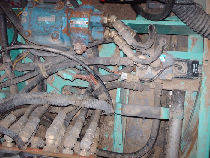

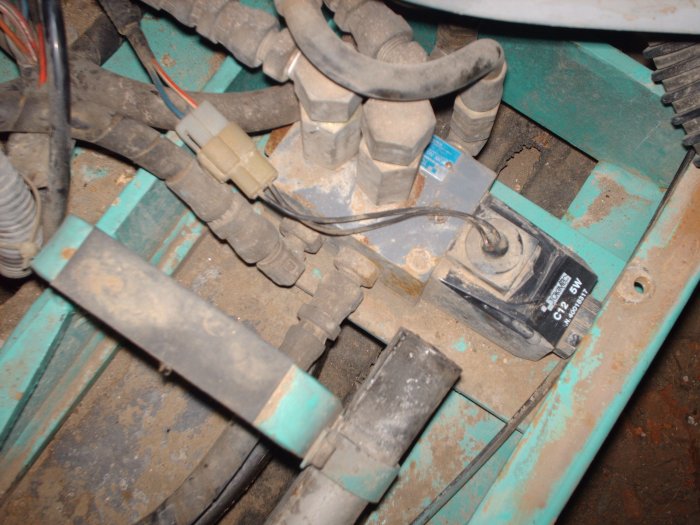

Slight problem on an IHI 4J mini digger. Other diggers have the same system, so it's probably not a problem that's particular to this manufacturer.
The left hand lever controls either slew / rotation or just the boom moving from left to right on the pin nearest the digger body, for offset digging.
The choice between the two options is usually made via a switch mounted to the right of the hour counter.
Problem is.... the boom is all the way to one side and the switching mechanism has failed. Only have slew function now and can't move boom back to centre.
Removed pin at end of hydraulic ram, so as to manually straighten the boom to get the digger into the van.
Question is...What lies between the switch (which i have tested, along with the connections 6 inches down the wires) and the hydraulic system, so it knows which function to operate?
Will get the top off tomorrow, but any idea what i'm looking for?
Thanks very much in advance. There appear to be some digger enthusiasts on this site, so fingers crossed.
Post some pictures.
, reason was a small stone in the joystick
- show us some pics
