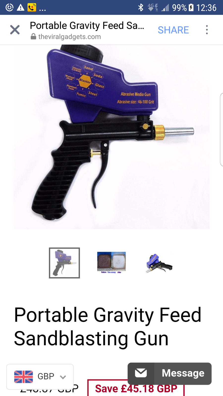

have u a week spareWould be interested in something for removing alloy wheel paint, but my 2.5hp 25l compressor probably is not up to it. Its a job that I dont mind doing slow with lots of breaks to do other stuff.
they wouldn't knock the skin of a rice pudding even a 90 psi pressure fed blaster would have a job removing the coatingWould be interested in something for removing alloy wheel paint, but my 2.5hp 25l compressor probably is not up to it. Its a job that I dont mind doing slow with lots of breaks to do other stuff.

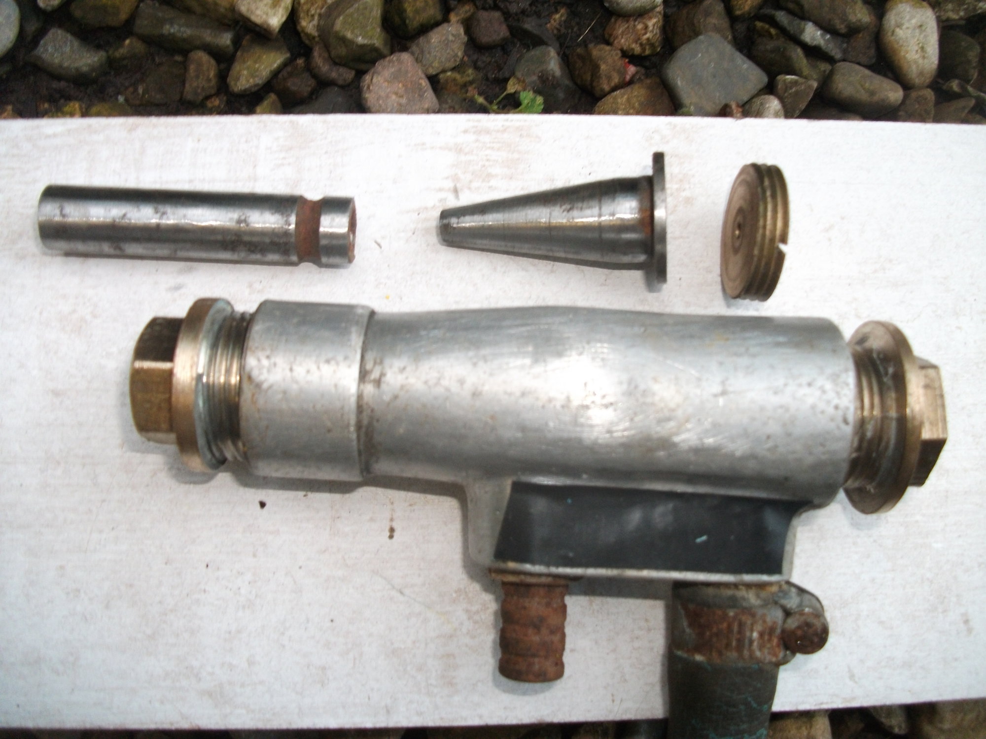

https://www.ajproducts.co.uk/winter...VMijTCh2XlAMtEAYYASABEgLP3vD_BwE&gclsrc=aw.dsThe downside of these guns is that the blast nozzle is usually not tungsten or ceramic so it will wear quickly which renders the gun scrap unless you can get spares.
or if u have a foundry u cast new bodies in ally using an old one u got given as a pattern and machine itSeen quite a few of the professionally used ones which are chunky alu type ones. The sides get blown out so we weld them up at work![]()
Alloy wheel paint is seriously tough, it took me a whole day to do one wheel with reasonably decent kit. After that I dunked them in paint stripper first.
