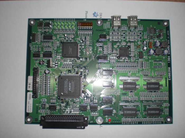

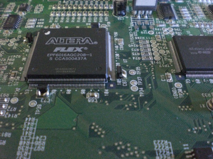

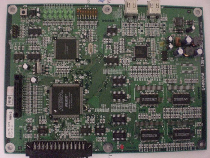

Hi guys,
Trying to help out a signmaker in one of the units neighbouring my own unit.
Guy has a problem with plotter as in title, the error seems to be a fault on the IF board, which handles all communications with the computer.
It seems its a very common failure point, and is a case of when, not if.
New board is over £1200, and as this one is now junk anyway I offered to cast my eye over it (i'm no electronics wizz - but what is there to lose). I looked at the capacitors for any with a blown vent and found nothing obvious, nor dry joints etc.
Did a bit of googling, and found there are some additional smaller caps I hd overlooked. Around these there does seem to be a deposit on the pcb. When scraped with a blade the deposit flaked off the PCB. This deposit is present in the vicinity of each of four caps which are around the periphery of a large IC.
I plan to obtain some replacements and solder them on anyway (not feeling at all hopeful). They are an odd design (to me), being surface mount and not metal cased. Appear to be made from the same resin type material as chips, transistors, gates etc.
Shouldn't have too much difficulty getting them from farnell or maplitz, but does anyone know their correct name?
And, is this a typical failure mode, for an almost clear deposit to be in the vicinity of the cap?
Thanks
