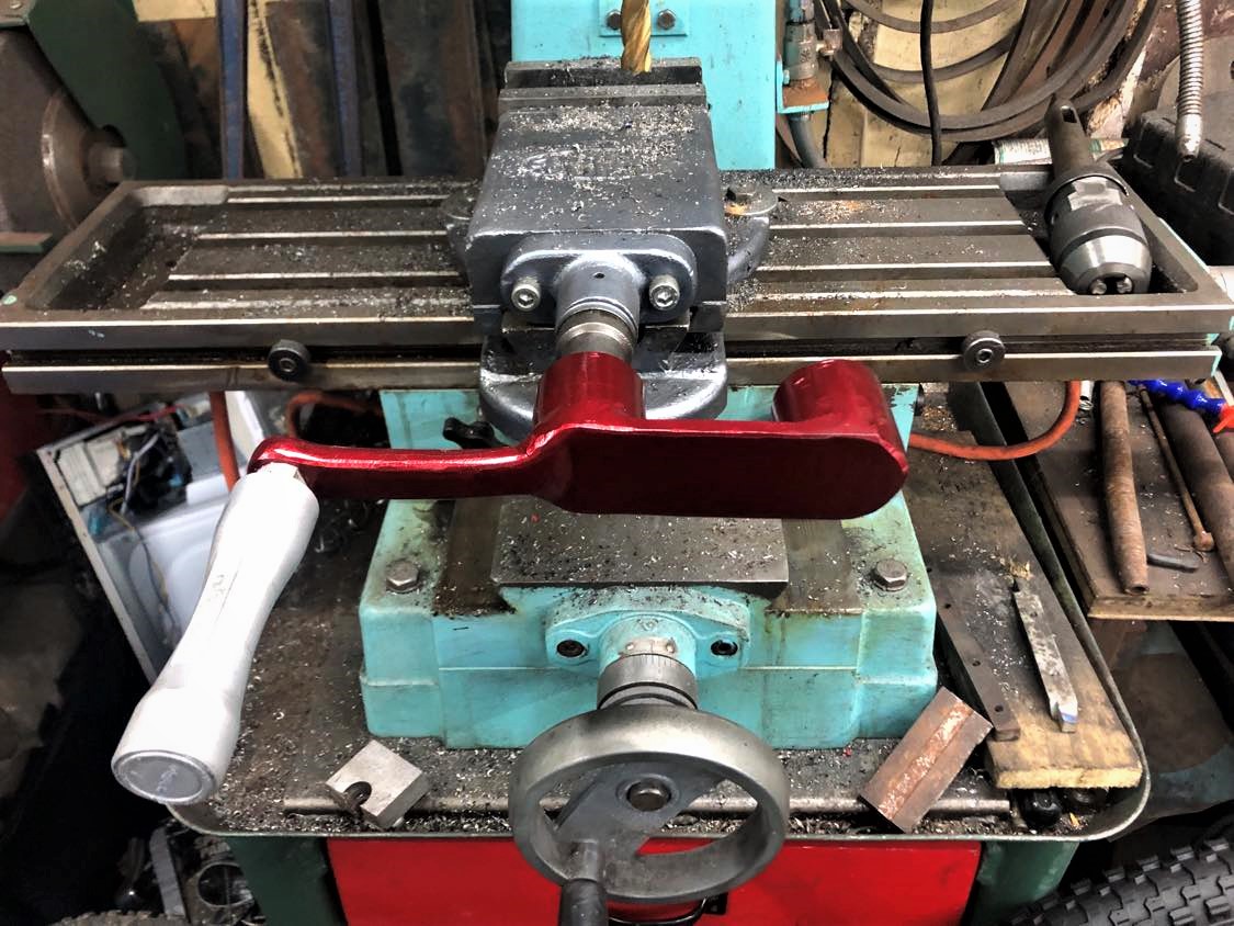

Ingredients, 4 pieces of 17 x 6mm angle 30mm long
2 pieces of 1 1/4" bsp 30mm long
1 piece 125 x 35 x 10mm flat bar
1 bicycle crank
1 cast alloy bicycle pedal.
Method, Blat the pieces together with arc and rods, create sparks with angle grinder, cut the sides off pedal and spin on lathe, find can of surplus spray paint and apply, screw middle of pedal into crank.
Job done
