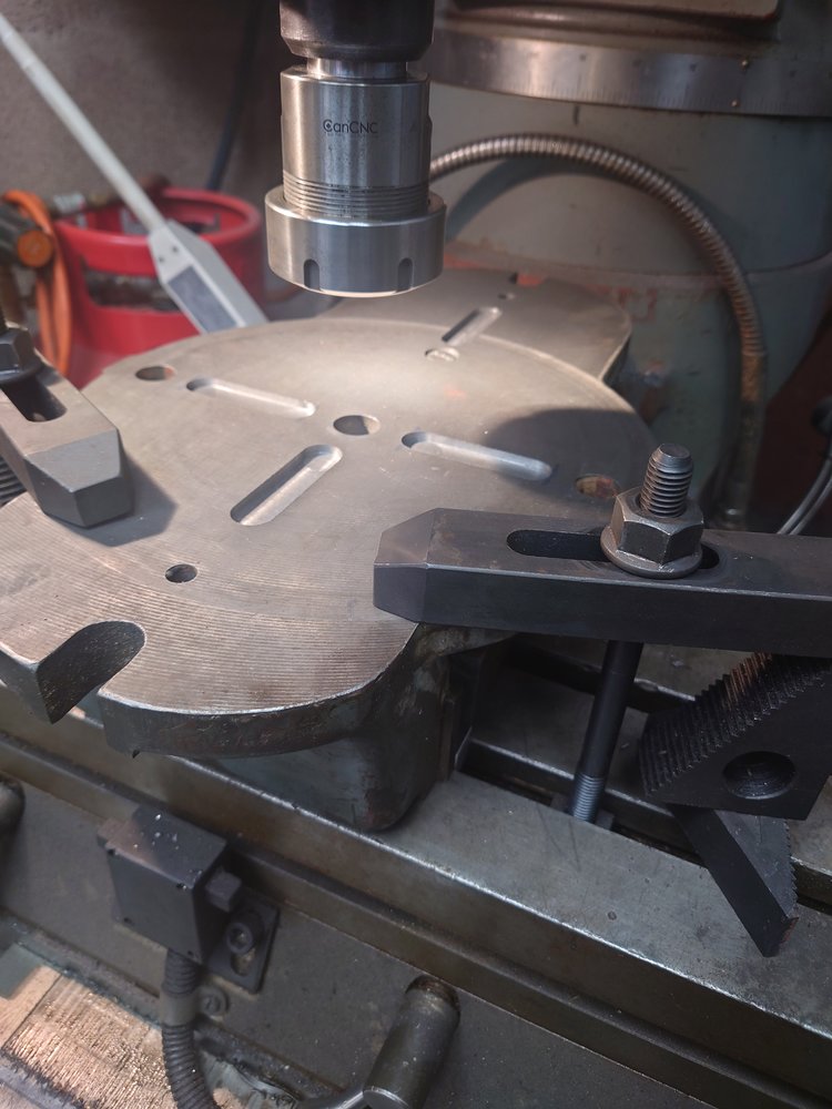

Hi folks,
Was having a nice morning until I flipped my newly keyed vice over to find it was 0.25mm out of line still with the machine.
I clamped a piece of brand new, VERY snug fitting, 5/8" key steel in the jaws, inverted the vice, tapped it into the tee slot at the front of the table so I could do longitudinal slots too for if I ever spin the vice 90° and used a new 5/8" end mill to make 4 slots using the dro to position after finding the centre location from the swivel base dowel hole.
I levelled the vice base to match the table, had it clamped tight, had the opposite way to the slots I was milling locked and took it easy cutting, all seemed lovely, until I flipped it, clamped down with tee nuts etc and stuck an indicator on the fixed jaw. Left to right I'm 0.25mm out over the 150mm (I think it's that long) jaw, which owing to the snugness of the keys I can't bump out.
Annoyed to say the least, I think the remedy will be some step keys and mill the slots out bigger, but how could it be so far off having it clamped to the key steel in the slot?!
Any advice and help much appreciated.
Cheers, Dan
