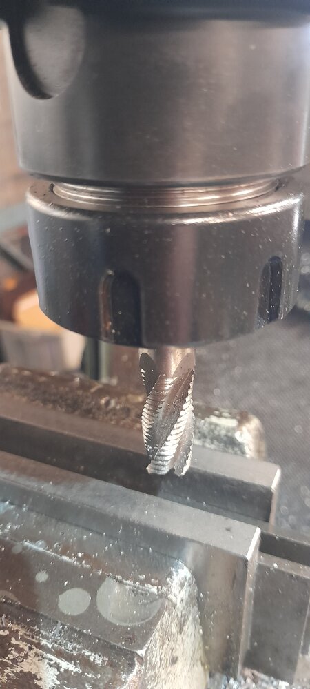

getting pretty close to having a working milling set up on the lathe...only anticipate doing small bits on there as i will only have about 80mm of travel in what would be the Y axis of a milling machine (will be up/down on my milling attachment), but the few projects i have in mind involve plunging and milling pockets.

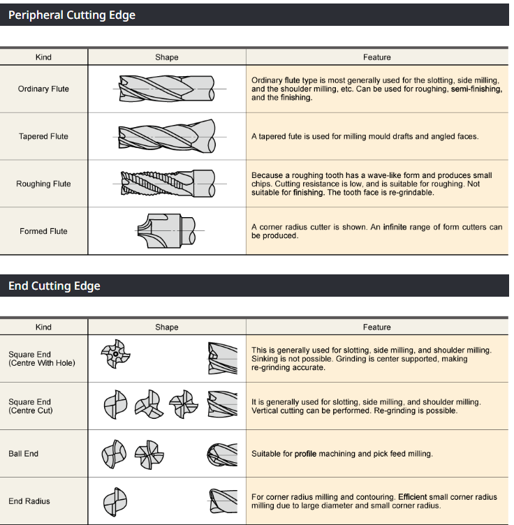

would a 2 flute end mill be better for this as i notice the 4 flute end mills i have all have a dimple in the centre which prevents plunging past maybe 2mm at most.
