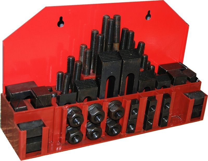

These clamp kits advertised as M10, M12, M14 etc.
What would be the best size for me to buy for my mill?
I think I would need a set with approx 15mm across the tops of the T nuts as the slots in the table are 16mm

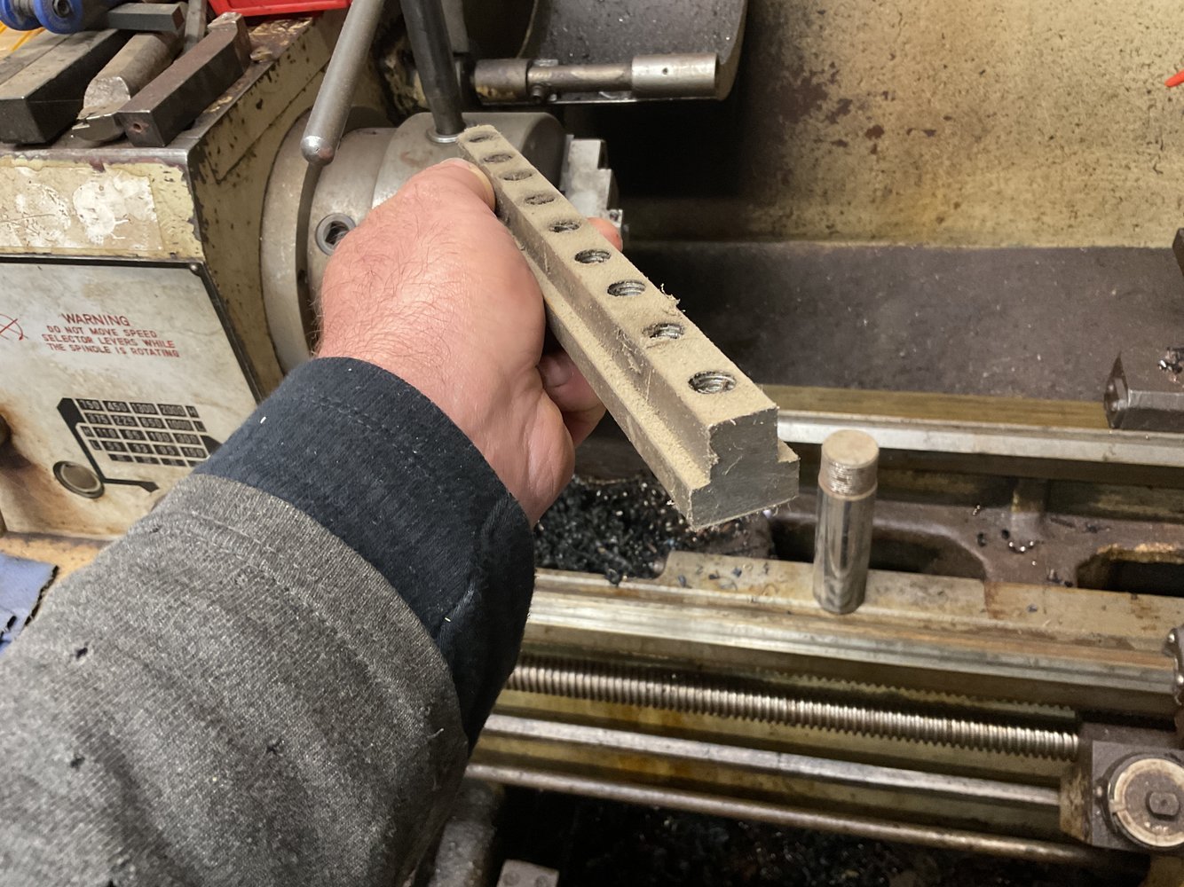

How did you clamp it though?I knocked up/drilled/tapped a length of T steel and I cut them off as/when I need them.

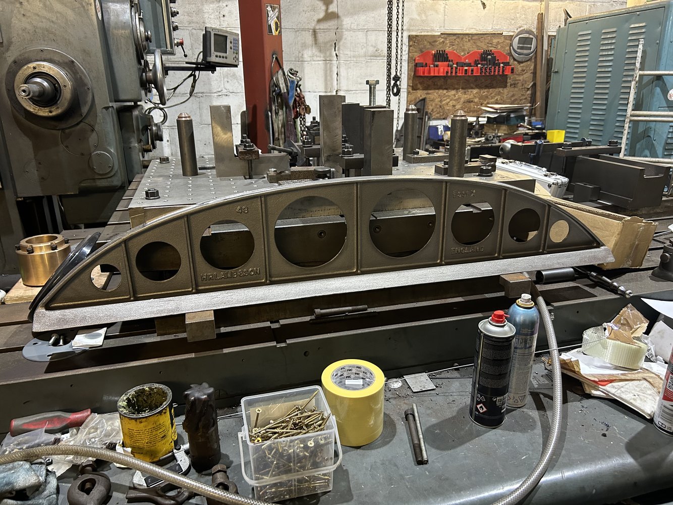

One of the fastest repeats, see post # 15,136
Can't remember the exact make now, think it has a SIP label on it somewhere.Most of the ones you show are copies of the Vertex ones (which are highly likely copies of someone else's).
What machine is it? Are the T-slots strictly 16mm metric or 5/8" imperial?

At the T-slot size you have, there are two (four) choices of stud size: I would be choosing the M12 option as threaded rod and bolts are much easier to get in that size than M14 or 1/2" UNC (or 1/2" BSW).
As above, it is always worth making some T-nut blanks - often you might have a part with a hole in it that does not fit the M12 stud, so you can make a nut with M10, M8, M6 thread.
Unistrut nuts can be used as emergency T-nuts.
