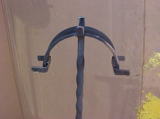

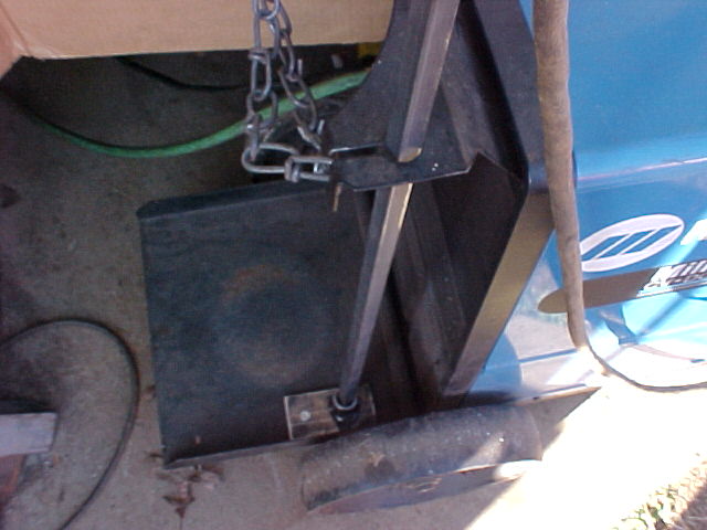

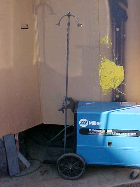

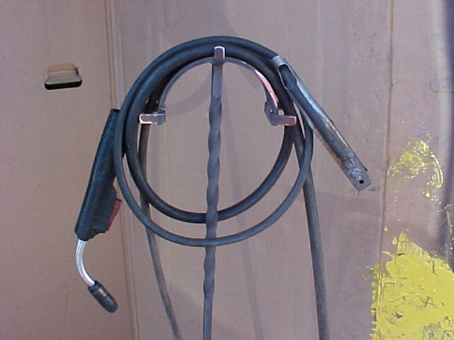

Here's my hose holder. Since i don't have my bottle on the back of my MM185 i don't have anywhere to hang my gun and ground. So i fabbed this simple hanger up from some stuff laying around the shop. You can add a simple shelf anywhere on it for your goodies too and it will swing out of the way. I put a bracket on the bottom rack and the rod then comes up thru the chain hole to keep it more secure plus it will turn in the bottom mount and can be removed in a few seconds. The bottle will still fit if i ever want to put it back...Bob
