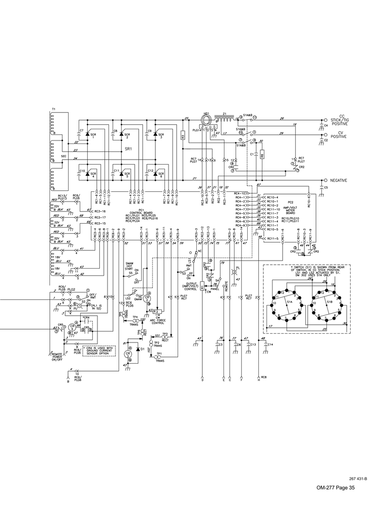

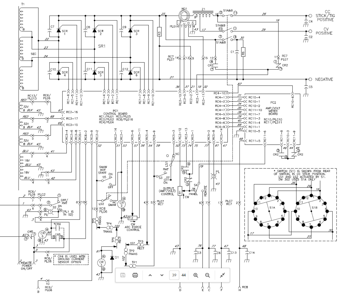

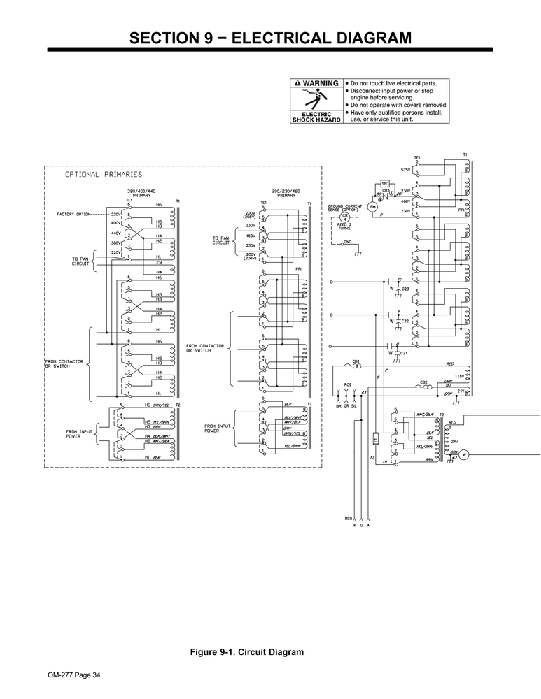

Hello all.
Hope somebody can help me up to figure out what the problem with my welding machine is.
I have this Miller Dimension 302 machine, and right after finishing welding anything or right after pushing the trigger for just a second, it does sparks when contacting with the working piece/table.
I've been doing research and found out something about the bleeding resistor, if damaged, that could be the cause.
Attached is the circuit diagram.
